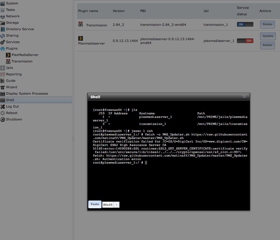

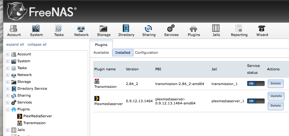

I just purchased the latest Apple TV, mainly because it now offers a Plex app. I downloaded the app, signed in to my Plex account, but my TV screen said Plex update is required.
I went into my Freeness GUI, and I saw an update to Plex was available. I clicked the Update button, it downloaded the update, and I changed the update status to ON. But the Update option is still showing, as per the image attached, and the Update Required message continues to show on my Apple TV.
Am I missing something? Please help.

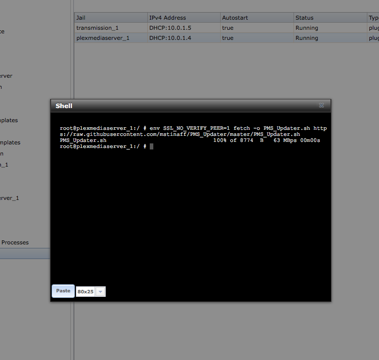

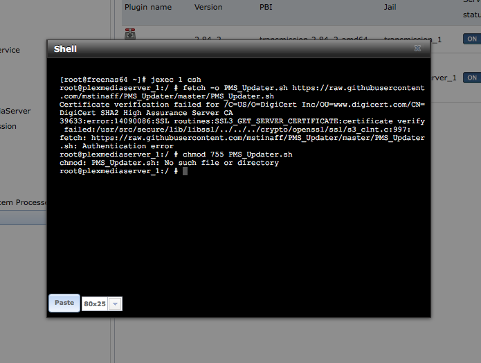

Thanks so much for the prompt response. I followed your instructions, copying and pasting the "fetch" command, but got the attached screen saying Cert. verification failed. So I continued with the next chmod line, but no such file was found. Did I miss something?

Try stopping the plex service in the GUI and run it again.

You're running the commands from the main shell prompt. You need to open the plex jail shell prompt and enter the commands there.

click on the jails icon at the top. Click on your plex jail to select it from the list. Once it is highlighted, at the bottom row there is an icon for a shell prompt. Click on that and it will open the shell prompt for the plex jail. Now run the commands listed and you should be gtg.
ETA: It will take a bit to download the update files and it will seem like nothing is happening. Leave it alone and let it finish and it should drop you back to the shell prompt when it's done.
Honestly I prefer doing all this over SSH using putty as the shell prompt in the GUI is limited in it's function.

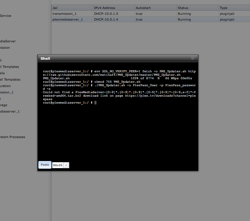

So I did exactly as instructed, and looks like I got the file. Do I also need to execute steps 5 & 6 mentioned earlier?
Jailer
Not strong, but bad
Sep 12, 2014
4,977
Yes
Couldn't get the last command to accept. Looks like everything is spelled ok. Any thoughts?
Jailer
Not strong, but bad
Sep 12, 2014
4,977
Ok had that problem last time I updated.
Do you have a plex pass?

No, I don't have the PlexPass subscription, just the media server that came as an available plugin on Freeness. Do I need the subscription to avail of the Plex app on Apple TV?
No you don't need one. Aparently this version of the script is still not working. I'll attach a working script file and you'll either have to SSH into your server using putty and replace the contents of the PMS_Updater.sh file or FTP in to place the script in the root of the plex jail. Just remove the .txt file extension and replace it with .sh if you go the FTP route.
This is way over my head, I'm afraid. I'm not savvy enough to follow either alternative, without explicit instructions. Thanks anyway for all your efforts.
