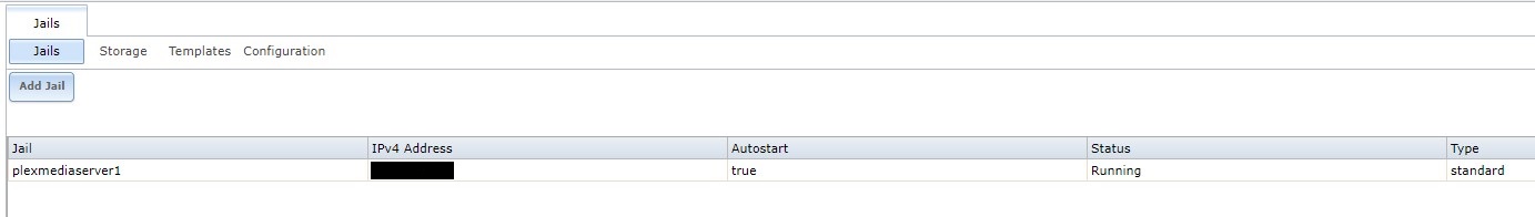

Plex has stopped working on PS4 and the Roku. It says it needs to be updated. I tried to update via following various forum posts, but it isn't updating. I have FreeNAS-11.1-U6 currently installed and I subscribe to Plex. Here is an image of my jail...
Thanks in advance!

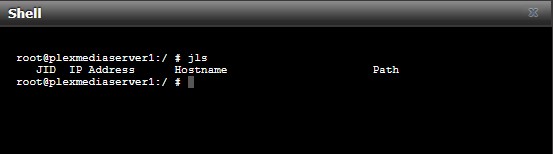

Doesn't work, no jls name found.

The commands need to run from the freenas shell. In your case you are already inside your jail. So run this part only.
Open the shell
Type: pkg update && pkg upgrade
after update finishes
Type: pkg install plexmediaserver
EDIT: Keep in mind that he is recommending that you install the pkg version of plex. If you did some kind of manual install, originally you might need to check your configurations point to the correct metadata locations to pickup your existing install.
