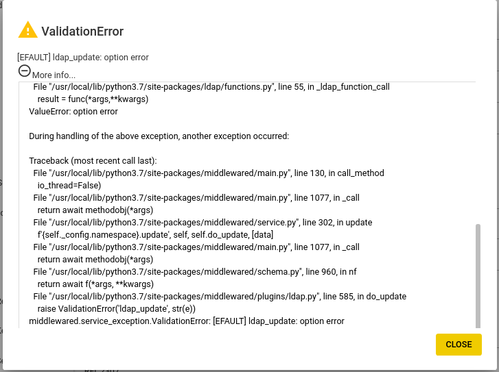

I am having the same issue on 11.3 with LDAP not working. What can I do to help troubleshoot?
I also get a option error when trying to enable the LDAP service, this is a brand new setup with a fresh install of 11.3

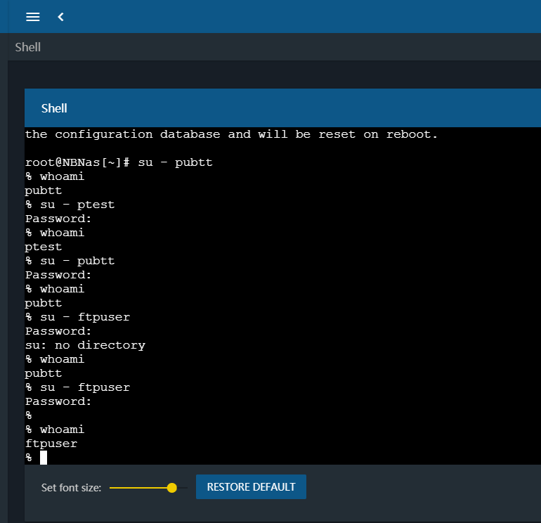

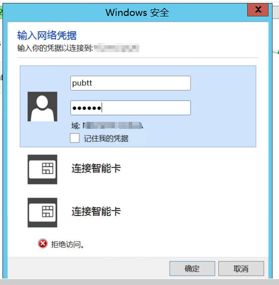

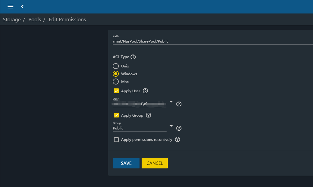

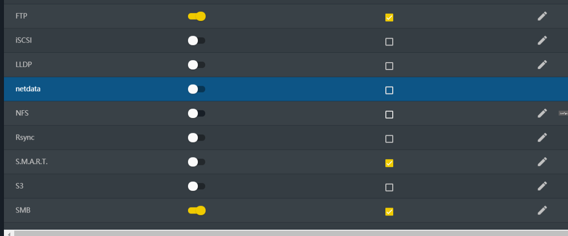

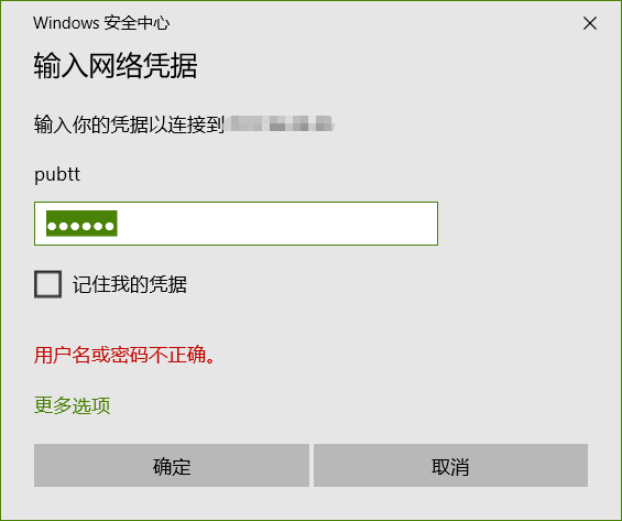

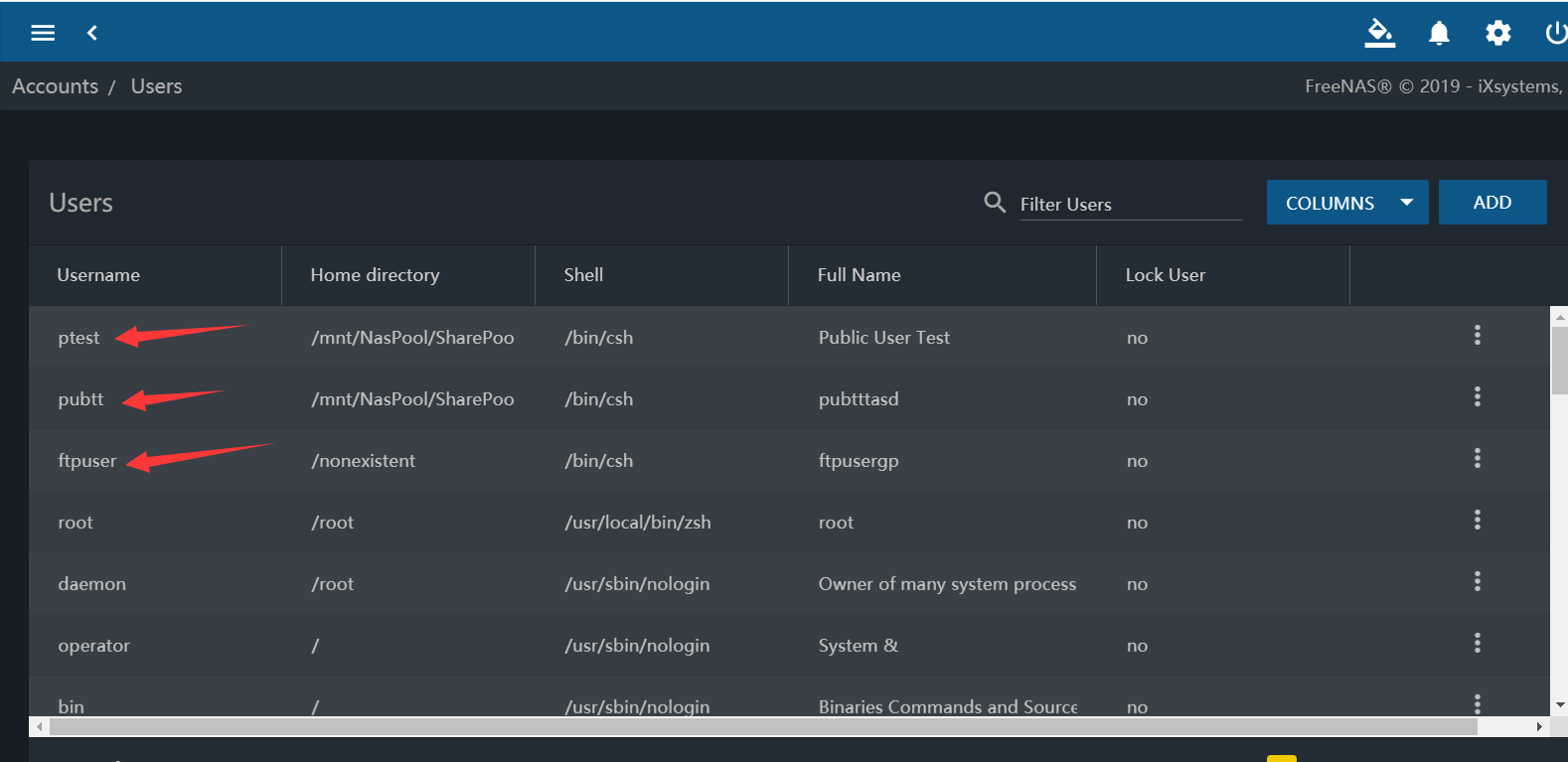

freenaslol
Feb 13, 2020
5
I downgraded to 11.2 U8, adding the domain is normal, the domain user and domain group are also normal, and the SMB service can access the space normally.
However, SMB cannot log in with a local account, prompting that the username and password are wrong; the fact is that the account password is correct, I tested it on the command line;
ftp login with local account is normal;
How can I disable domain login when logging in with a local account?
Login in a non-domain environment, directly enter username "pubtt", and still prompt the username and password error;
After Freenas enables the domain, can't I log in with local users at the same time?:(
I hope U2 can be released as soon as possible, and resolve the compatibility issues between domain and local accounts at one time;:cool:
anodos
Sambassador
Mar 6, 2014
9,553
If you are authenticating with a local (to the FreeNAS server) account in an AD environment, you must prefix the NetBIOS name of the FreeNAS server to the account name "FREENAS\pubtt".
