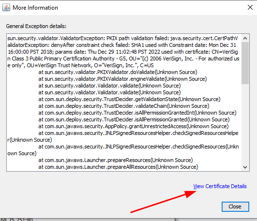

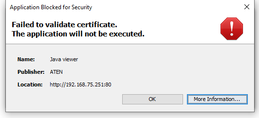

3. ATEN Java iKVM Viewer, which asks: Do you want to continue? The connection to this website is untrusted. The certificate is not valid and cannot be used to verify the identity of this website.
4. I click Continue --> "Connection Failed".

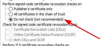

2. In Java settings, added IPMI URL to exception site list for security
4. In Java settings, I tried to weaken some security settings that looked like they might be related.

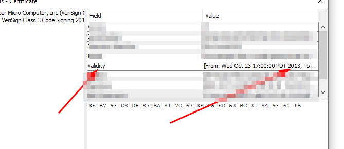

5. As the original cert was expired, I created a new private key and self-signed cert for IPMI using SuperMicro's instructions and uploaded at Configuration > SSL Certification. These were accepted by the IPMI and then by my browser, after I convinced it to get past the self-signing.
But it made no difference in starting the iKVM. Help please! The Supermicro firmware is v. 3.72, May 10 2018.
Now I can't get it to work. Here's what happens:
1. Click on Launch Console.
2. A file 'launch.jnlp' is downloaded, which on a mac I have to right click to open it with Java Web Start. It in turn opens:
