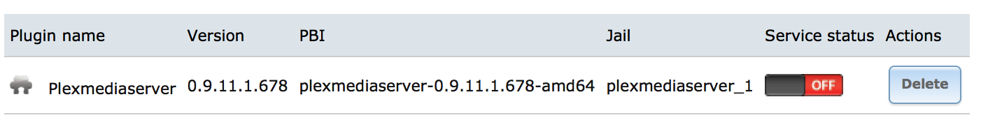

I can't seem to get the Plex media server plugin to run under 9.3. I thought it was because i had previously had it installed under 9.2 (and had GUI upgraded to 9.3), but I deleted both the plugin and the jail and reinstalled the plugin and it still won't startup:
When I try, I get the console error:
Nov 19 22:48:36 bethel manage.py: [plugins.utils:92] Couldn't retrieve http://192.168.1.69:443/plugins/plexmediaserver/1/_s/status: HTTP Error 400: Bad Request
and the service status is stuck on OFF. :-(

Have you enabled HTTPS in your GUI? If so, this is a known bug and you can work-around it right now by simply using HTTP.
RoboKaren
Apr 8, 2014
130
Brilliant. Flipping the GUI protocol to HTTP+HTTP solved the Plex media server problem. Thank you!!!
