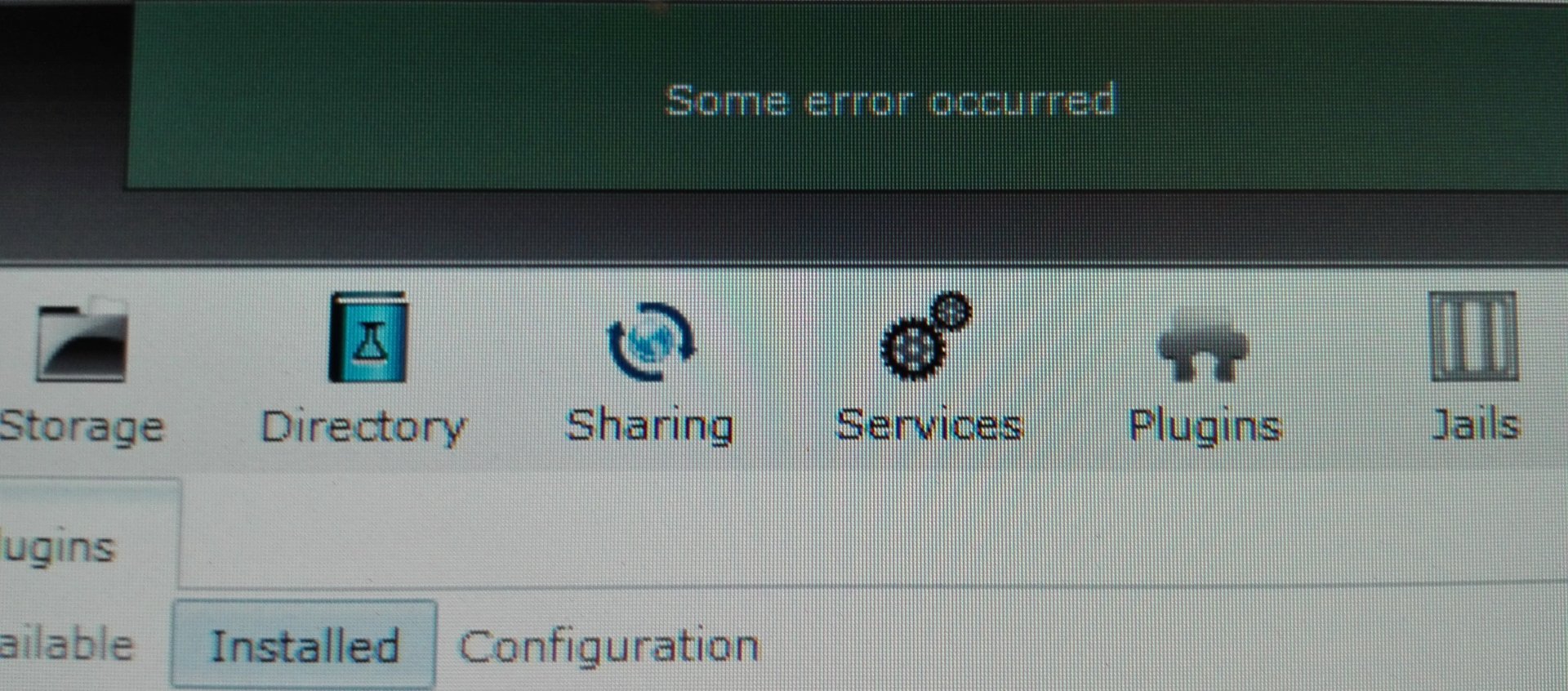

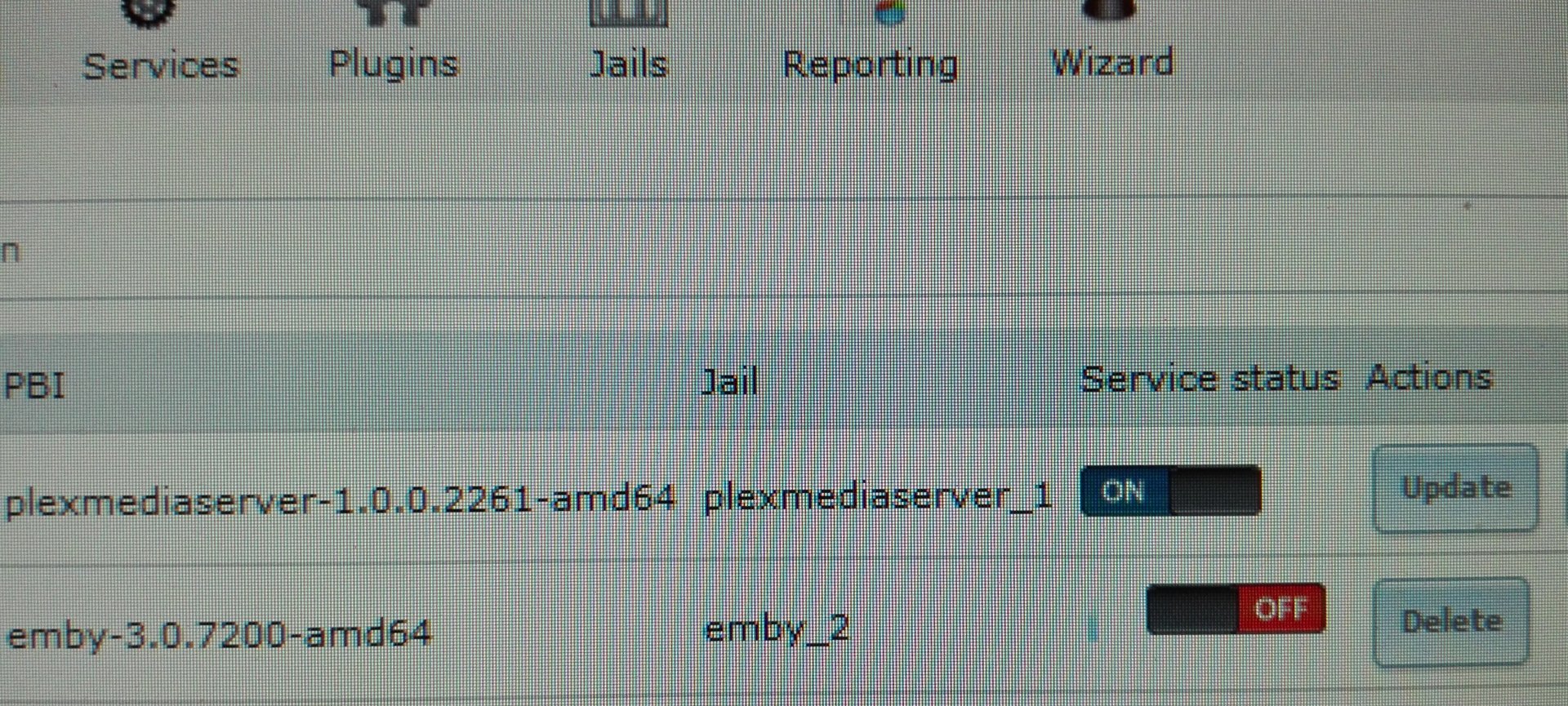

I was previously running FreeNAS 9.10.1 and had both emby and the plexmediaserver running without any problems. I have just updated FreeNAS to 9.10.1-U2 and when FreeNAS rebooted back up to the gui, the emby plugin was missing from the left hand side menu, but plexmediaserver was still there. I reinstalled emby and it stayed in the OFF position, so after numerous times of trying to get it to turn ON, I gave up.

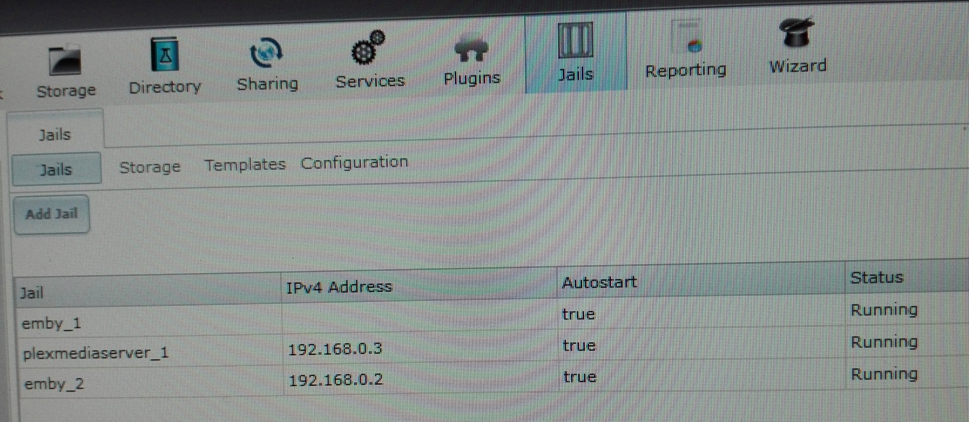

When I looked at the JAILS tab it shows that emby is running, yet no devices can acess the plugin
I took some screenshots and added them

if this works from the jail then the issue is with the jails networking
service emby-server start
I recommend you try disabling VIMAGE for the jail and assign an actual interface

After I disabled VIMAGE, I found that the emby IP address was not reachable, ie Ping 192.168.0.2, and comes back with request timed out. So I then enable VIMAGE and Ping 192.168.0.2 again and this time I get a reply.
