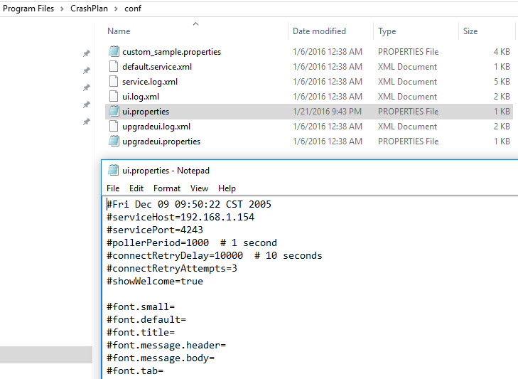

I'm trying to get Crashplan working to backup my Windows 10 computer user files to my Freenas. I've installed CP 4.5.2 on the Windows computer and edited ui.properties.
After installing CP in it's own jail I tried to navigate to the .ui_info but can't find it per http://support.code42.com/CrashPlan/4/Configuring/Using_CrashPlan_On_A_Headless_Computer Step 1.
