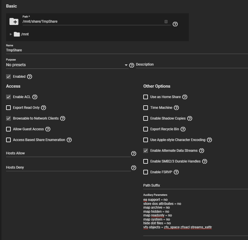

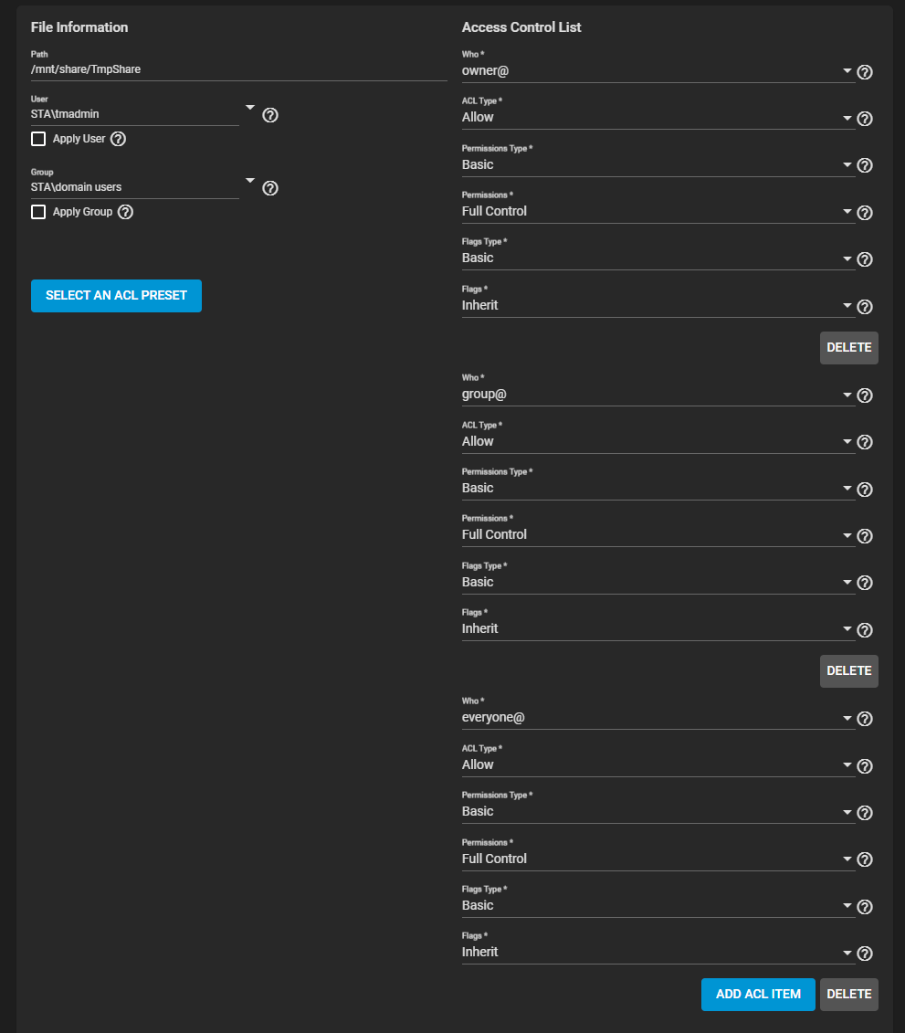

Here are the permisions:

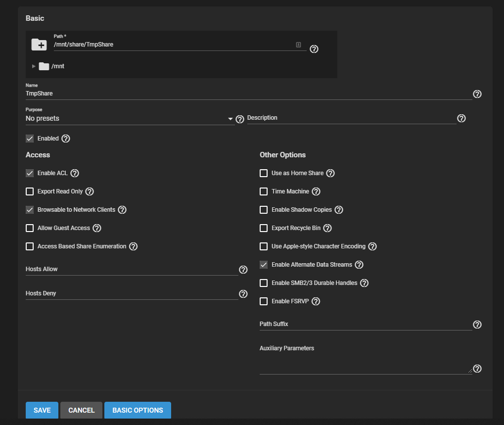

Thanks for the reply. The recycle bin wasn't enabled on this share, so I removed the auxiliary parameters but it didn't help.
Do I need to restart Samba to apply the changes?

OK, I restarted SMB and I'm still unable to delete the file. I'll see if I can send you the core file now.

@anodos Hi, I'm not shure if it's the same bug , but since upgrading to Truenas CORE 13 i'm getting lots of samba core dumps. I thought the problem was related to some auxiliary parameters, but after switching to default config, i'm still getting core dumps. May I send you my logs in order to understand what's happening?
Best regards
