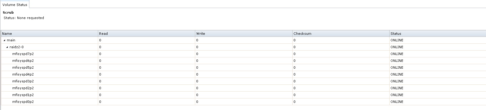

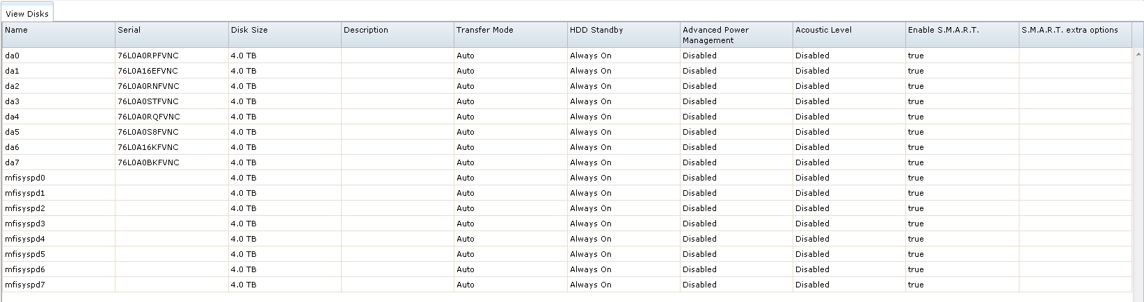

I use the Wizard, or the Manaul mode to make a volume, It thins for a second, then back to the screen, no error messages posted.
Below is the full tail -f of the messages log while trying to create a RAIDZ2 volume with disks da0-4

Yes I can create volumes with the 'myfisysdn' disks, per the attached screen shot.
I am not using encryption that I know of.
As for the paritions on the drives, as far as I know they are empty.

Matt Kent
Jun 21, 2016
24
The long SMART test had no reports, and "smartctl -a /dev/da0" and smartctl -a /dev/pass0" showed the same information.
I've physically flipped the drives from the server to the shelf, and shelf to the server, keeping the same relative position of the drives, and still have the errors.
They even showed up as part of the drive disconnect and re-connect.
The first section of the log is below, the full log is attached.

First the drives form the server, identified as mfisyspd0-7 removed, then pd0-7 were removed.
Drives previously known as mfisyspd0-7 were placed in the drive enclosure counting down from 7. Getting the new names of pd0-7
Then pd0-7 were put in the server, counting down form 7 to 0 again. and now being named mfisyspd0-7
I did create a volume on mfisyspd0-4 in RaidZ2 configuration, and was not able to create one on pd0-4.
Matt

What in the log it making you think hardware RAID is involved?
Matt
Aug 21, 2016
7
I think you should test the lsi card. Try using completely different drives just to test it works properly. I've seen suggestions to check cables & other things. The weather has been hot lately. Unless you keep it in an AC cooled area. I'm just focusing on the last lines UNCONFIGURED BAD & periph destroyed. B4 you go nuts any further make sure the card is 100% good. (Haven't read every response)
Sent from my SM-N920P using Tapatalk
depasseg
FreeNAS Replicant
Sep 16, 2014
2,874
seeing /dev/mfi and /dev/pass devices.
Drives can be presented as individual "JBOD" via a HW RAID controller and some think that they aren't using HW RAID, when they actually are. In this case though, the LSI does look like it's in IT mode, but I'm not sure about the H730.
I think there is an issue with the driver and H730 controller combo. And either a physical issue between the LSI and the MD1400, or an incompatibility with the MD1400.
Aug 21, 2016
7
Yeah I there are driver compatibility issues with freenas....
