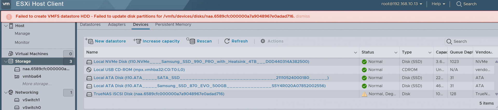

Can't create new datastore on esx 8 with iscsi ZVol
dwchan69
Nov 20, 2013
141
Is there any reason when new datastore creation on a simple 100GB Zvol fail with the following on ESX 8. Zvol block at pool level is 8K, while block level for the extent is the default 512. Any comment would be appreciated
