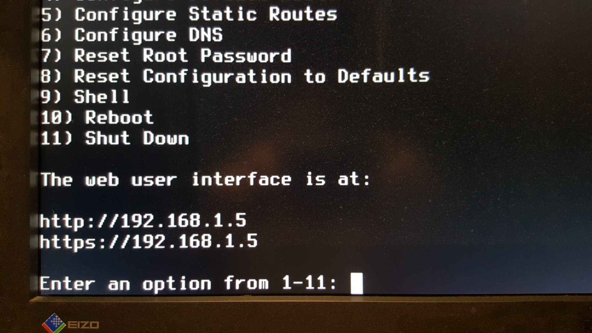

SlowHorse
Apr 26, 2022
13
Here is the console screenshot
15,504
That's going to be a problem, then; the addresses need to be in the same subnet. Try setting the NAS to something in 192.168.0.x.
