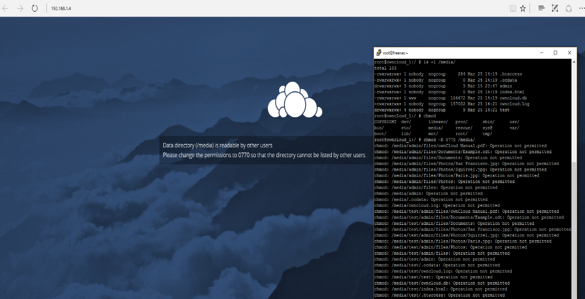

Same exact error here when I use "chmod" to change permission of the /media dir. Please see attached screenshot photo.
Also, same thing happened when using setfacl. See below.
root@owncloud_1:/ # setfacl -m user::rwx,group::rwx,other::--- /media/
setfacl: media/: branding mismatch; existing ACL is NFSv4, entry to be merged is POSIX.1e
Your setfacl command is wrong. The syntax for NFSv4 ACLs is setfacl -m owner@:full_set:fd:allow, group@:full_set:fd:allow /media/, but this doesn't recurse. It looks like owncloud wants you to get rid of the "everyone" ace. You can do this through the following command find /media -exec setfacl -x everyone@::allow {} ;\

Did run the command as follows but nothings happened. Should I replace "everyone" to something?
root@owncloud_2:/media # find /media -exec setfacl -x everyone@::allow {} ;\
