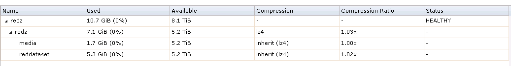

1 volume: redz
1.1 dataset: redz\media
1.2 dataset: redz\reddataset

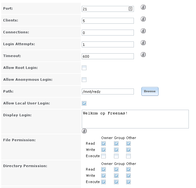

FTP
path: mnt\redz
allow local user login checked
File permission all is checked for read write
Directory permission all is checked for read write execute

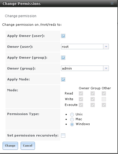

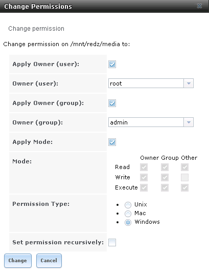

I can upload files and create new files. But when I create a directory I get the following error:
Response: 550 DIRNAME: Operation not permitted
Jan 19 17:52:30 freenas proftpd[65302]: 127.0.0.1 (192.168.1.121[192.168.1.121]) - chmod(/s/.dstOUvNtkFO) failed: Operation not permitted
Why can't I create directories?

You have the permissions type set to "windows". This prevents you from being able to chmod files. FYI, you shouldn't share the same dataset via FTP and CIFS simultaneously. The FTP server doesn't understand windows oplocks, which are used to agressively cache things client-side, and it can lead to file corruption.
