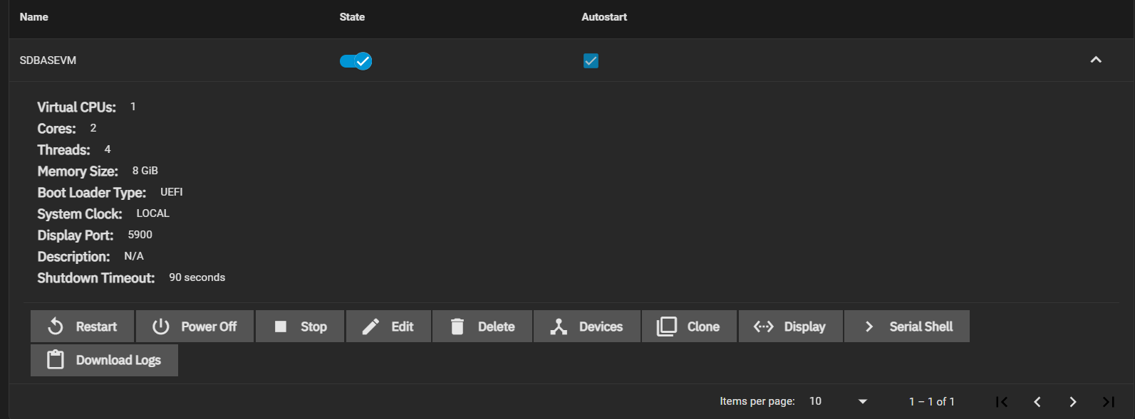

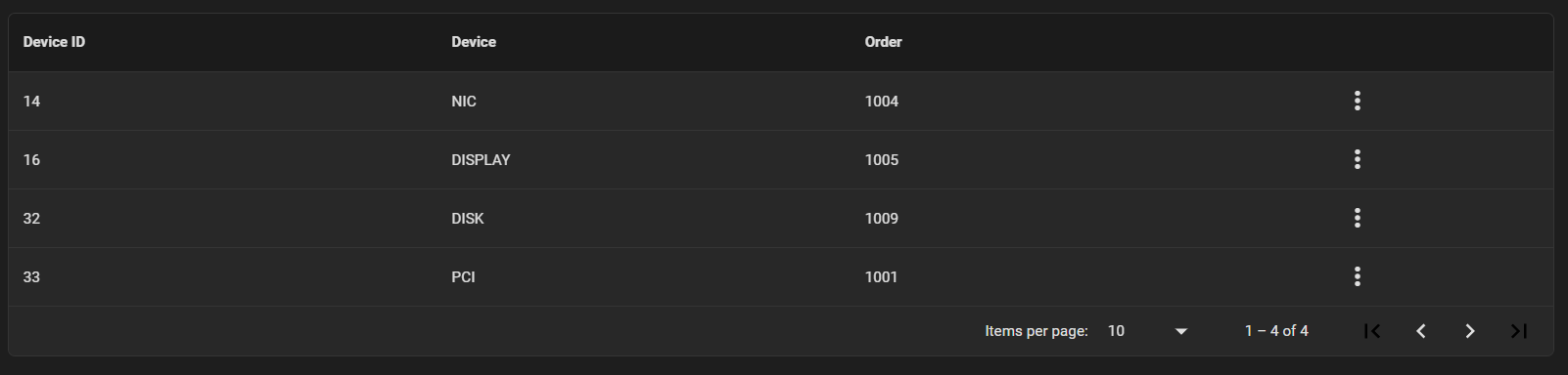

Hello everyone, I need help with a virtual machine on TrueNAS SCALE. The issue is as follows: I have a virtual machine to which I assigned an NVMe PCIe through PCI passthrough. This disk contains a Windows Server system functioning as an SQL server. The problem seems to be that the device order only affects the virtual disks (Zvol) and CD drives. When I start the virtual machine, it boots directly into the UEFI Shell, and I need it to boot from the NVMe disk. I've tried changing the boot order in the BIOS/UEFI, but it doesn't persist, and ideally, I don't want to manually select the boot disk every time the machine restarts or powers off, as it's an unattended machine. Your help would be greatly appreciated.
Host OS: TrueNAS-SCALE-23.10.0.1
Host CPU: AMD Ryzen 5 3400G with Radeon Vega Graphics
Host RAM: 24GB
PCIe Passthrough device: Kingstone SSD NVME SNV2S/250G
PCIe device ID: 0000:06:00.0 'Non-Volatile memory controller': Not Available by 'Kingston Technology Company, Inc.'
Guest OS: Windows
Guest RAM: 8GB
