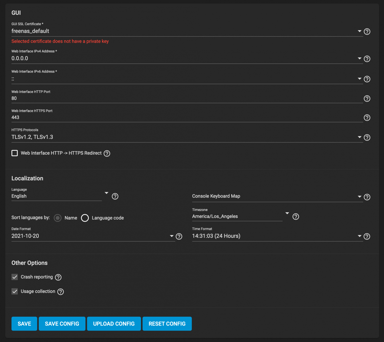

Due to this error:
Selected certificate does not have a private key
Any ideas?

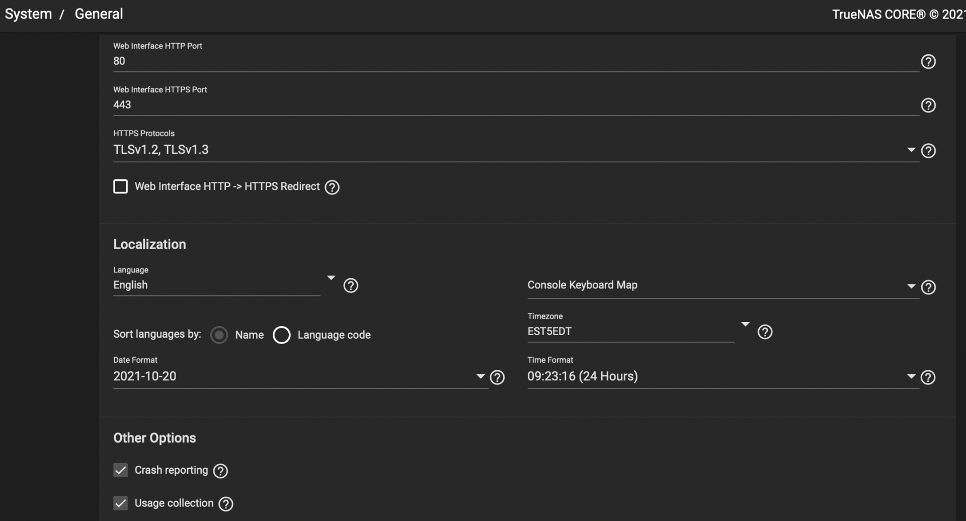

A little light on specifics, but...
You have any anything unique in NTP config?
Seem pretty straight forward to me.
JohnAtl
Sep 9, 2021
9
I agree, should be a no-brainer.
Even just clicking Save without changing anything gives the error.

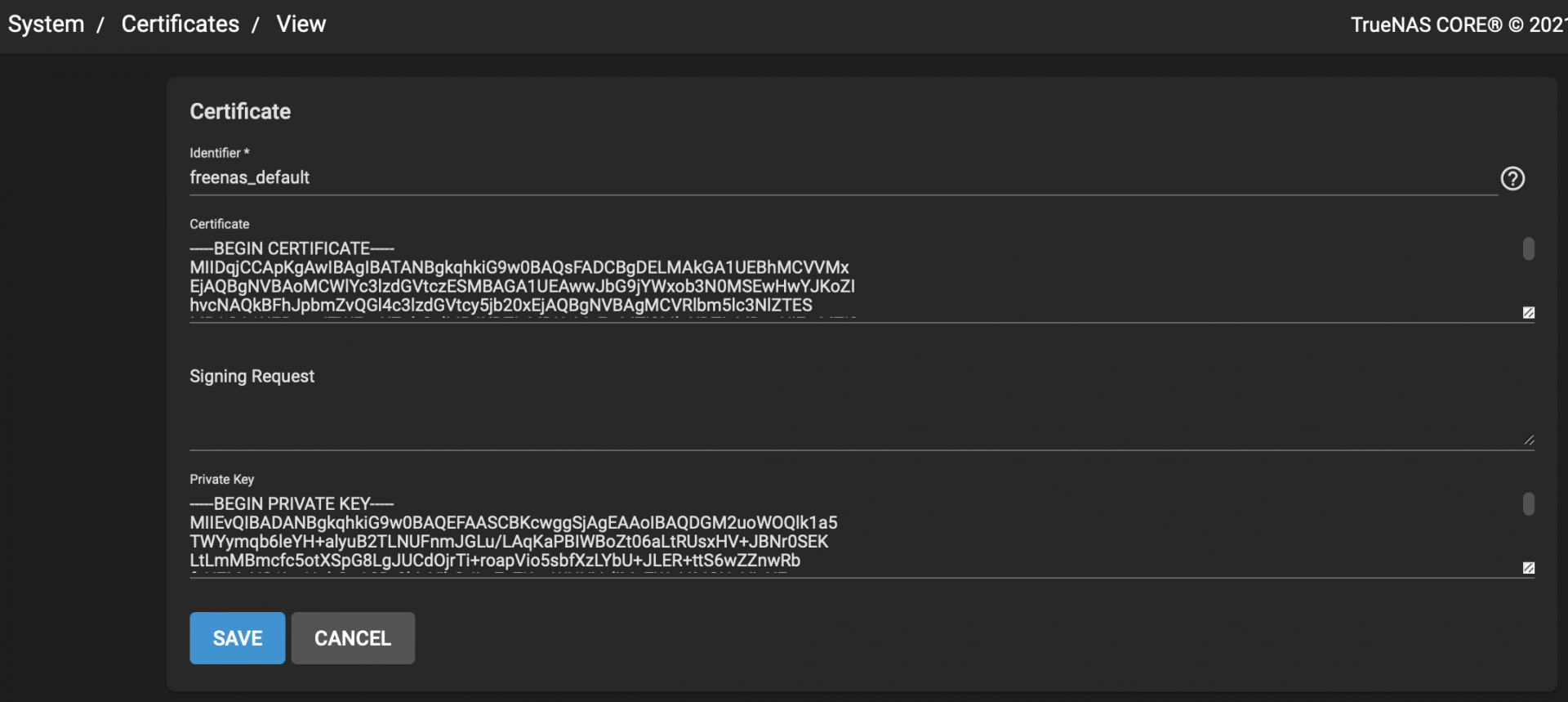

Jun 2, 2019
590
That seems too be more of a problem with the freenas_default self signed certificate than just TZ
