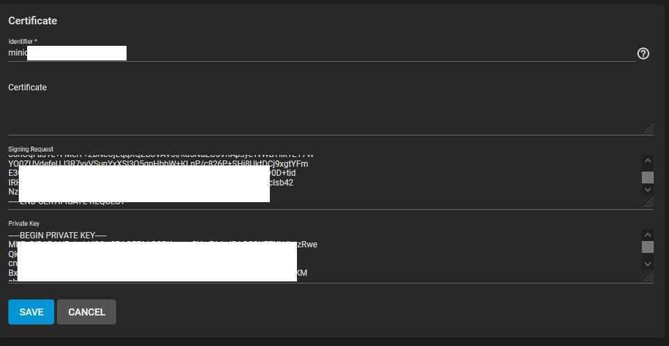

This is incredible... AGAIN.. but now a different problem.
I cannot paste a certificate into the appropriate part of the website. It is grayed out.
(Using a Let's encrypt cert is not an easy option now bc it involves creating that ACME DNS account, which involves making an Amazon user, and key pair or whatever, way too complicated bc this is a testing machine that I upgraded from v. 12 to v. 13). Seems like the certificate signing system is broken because of that.
I already have a signed certificate!)
