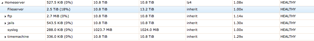

Thank you for your help, i dont believe the dataset is full as it is showing only 18% utilisation (Screenshot attached).
