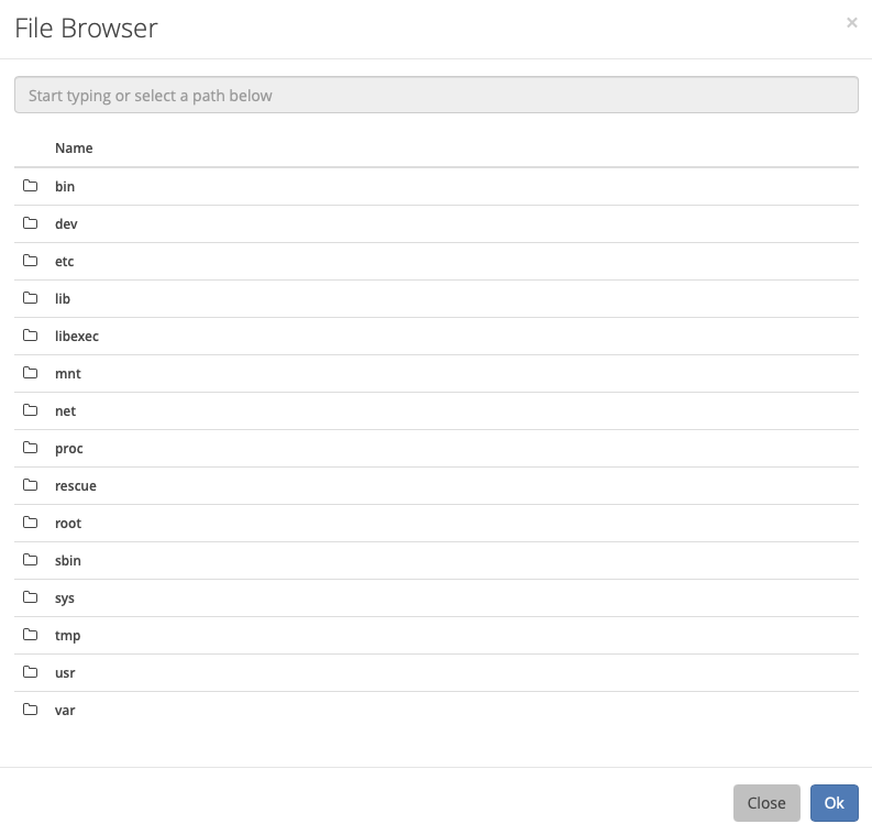

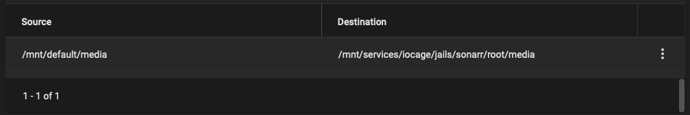

I Installed the Sonarr plugin and set a mount point:
When I try to add a series, I don't see the media directory?
If I remove the mount, the /media directory shows up. I don't understand how am I supposed to save my files inside the default/media?

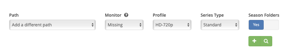

I would expect to see a real path, instead of the message "Add a different path":
Jan 7, 2015
1,153
sonarr by default cannot read a directory owned by root. Sonarr can only read directories owned by sonarr. If you are absolutely sure you want everything root owned youll have to set sonarr to run as the root user or join sonarr to the wheel group. I dont recommend this.

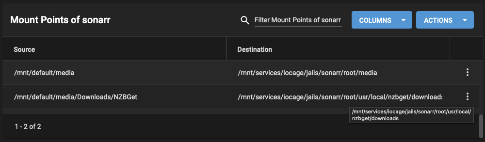

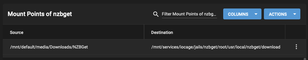

@John Digital I do have an issue:
Import failed, path does not exist or is not accessible by Sonarr: /usr/local/nzbget/downloads/completed/Series/...
/usr/local/nzbget/downloads is a path present into NZBGet plugin jail and linked to a mount point on my default tank.
What is the proper way to allow files downloaded in NZBGet become available in Sonarr?
Edit: I fixed the issue by adding a link to the source:
Now I can see inside Sonarr the files:

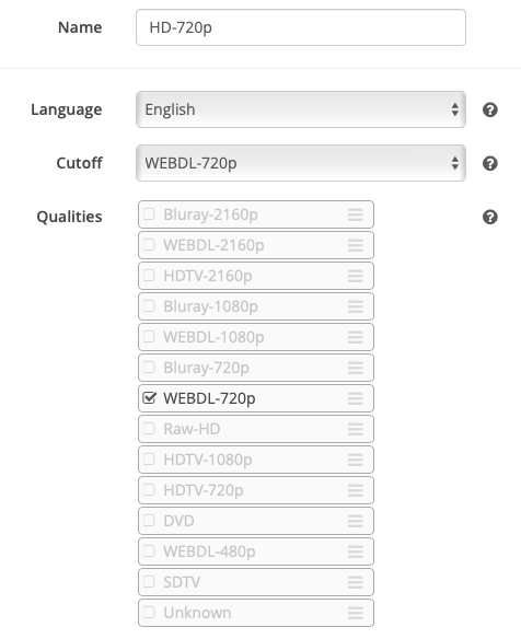

There is one small feature that does not work as expected. I have a WEBDL-720p profile:
Once the files are copied into appropriate series directory, the monitored status is not toggled off, like existing files which were present prior Sonarr install. Is there a setting I need to enable for this?
I'm curious why the existing files are tagged HDTV-720p while the new file is tagged WEBDL-720p? I presume Sonarr only labels the downloaded files, for the rest it assigns the lowest quality label.
