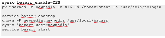

Hello. I'm having trouble setting up Bazarr on my FreeNAS server. Installed it as a community plugin so it has its own jail. My goal is to give this plugin proper permissions to my media directory. For plugins there's a guide here https://www.ixsystems.com/community...plugins-write-permissions-to-your-data.27273/
Newmedia is both the user and groupname that is used for my media directory. Sonarr and Radarr (installed in another jail) are using this successfully.
Inside the bazarr jail I used these commands. See screenshot.
I get this error when starting bazarr from the terminal
root@bazarr:~ # service bazarr start
Starting bazarr. daemon: open: Permission denied
/usr/local/etc/rc.d/bazarr: WARNING: failed to start bazarr
Any tips on how to get this plugin to work?

I got the plugin to work and did all the settings but I need the user "jailuser" to run bazarr and now I get the same error as the OP...
