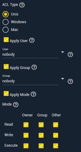

Death Dream
Feb 18, 2019
24
The dataset you are using as the mount point can be made so the owner is "nobody" and the "other" has write access. I'm using the same dataset for multiple plugins that need the same rights. This was just the easy option for me.

Daniyal
Mar 4, 2019
18
did you change the permission on the main pool or the data set e.g. media?
