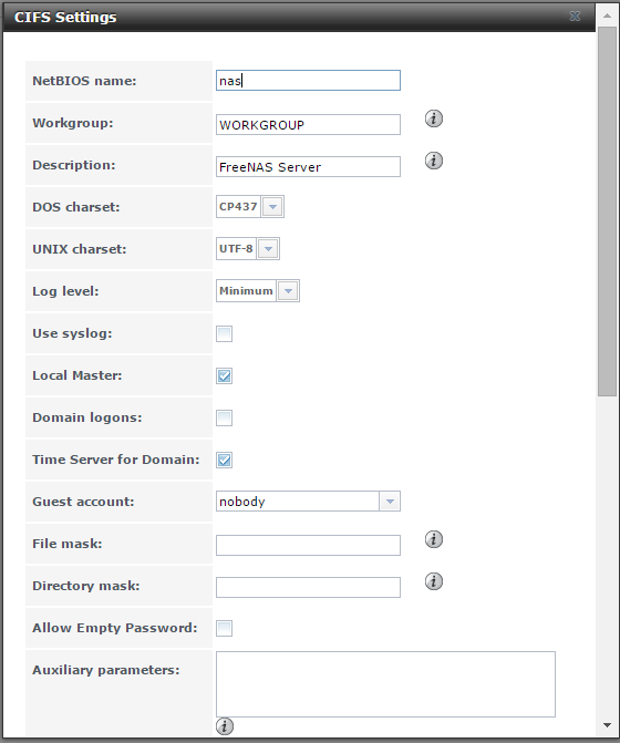

Hi guys, this is my first post so be gentle. I am trying out freeNAS on some temp hardware as a replacement for my old Windows Home Server before I go ahead and install it on my main server. I have installed 9.3 and following the freenas tutorials on youtube to enable windows shares. I enabled cifs sharing and I can see the nas in my available network computers (i can also ping it AND I can connect to it with no troubles through my browser to the config page). The problem is, when I try and connect to the nas I just get a time out error or an error saying no such computer existing on the network. I have even tried to mount the share using the \\IP\share but I just keep getting the prompt for the user/password (which does not work).
The steps I have taken are:

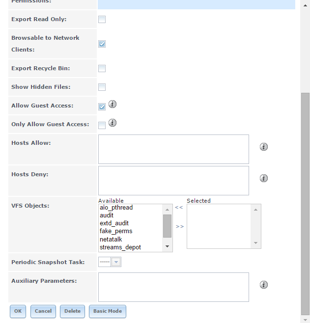

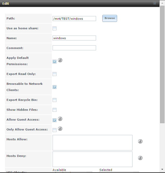

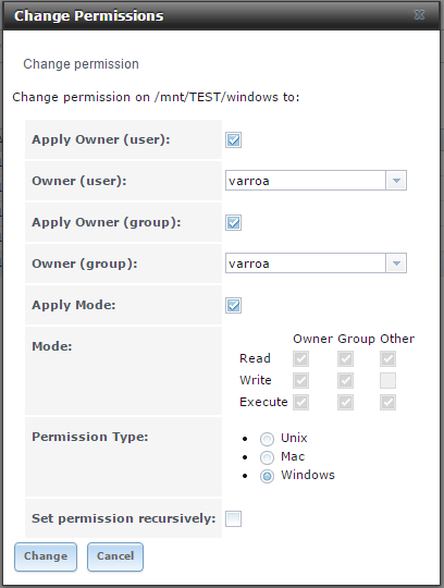

Create a ZFS data set and set it as a windows share type (named as windows currently), changed permissions of the data set to give me ownership (also checked allow guest access). Then add Windows share (CIFS), pointing to the new windows ZFS data set. Enabled CIFS process. Server is also set to have a static IP through my Routerboard.
FreeNAS 9.3
Q9550, 8 GB DDRII, Asus P5Q pro motherboard, Intel PCIe NIC, 30 GB SSD for boot, 1 TB WD green for zfs volume.

When using the IP address, have you triple-checked the user name and password?
Robert Trevellyan
Pony Wrangler
May 16, 2014
3,778

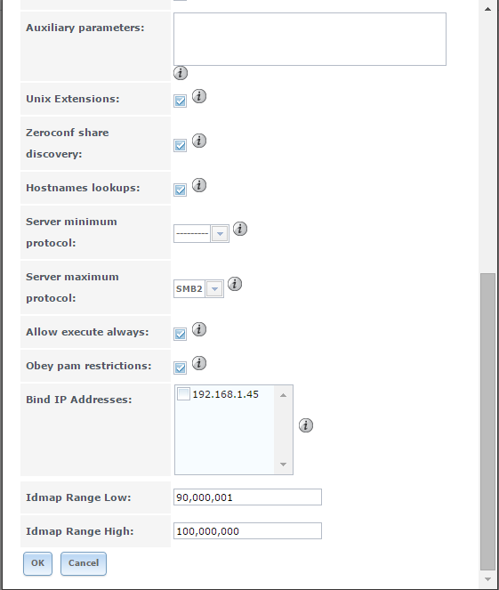

Can you post screenshots of the dataset permissions, the share settings (with advanced) and the CIFS settings?
Is Browsable to Network Clients checked?
What do you have set for the guest user? Does it have access to the share?
Have you tried with guest access disabled, or with only guest access allowed?
Is Browsable to Network Clients checked? YES
What do you have set for the guest user? Does it have access to the share? Nothing set for guest but I did try a guest account in the past.
Have you tried with guest access disabled, or with only guest access allowed? Both

Here's what I see when I compare my CIFS share, which works for my Windows 7 boxes and Macs, and yours. Anything I haven't mentioned matches with yours. I don't know enough to tell you whether any of the differences are significant.
  1. The name of my share is not the same as the name of the dataset.
  2. I am not allowing guest access.
  3. My workgroup name is consistent across all devices (obviously I don't know if yours is).
  4. My Local Master is unset.
  5. My Time Server is unset.
  6. My Hostnames lookups is unset.
  7. My Allow execute always is unset.
You did the right thing by posting your debug output in your original message, but unfortunately I'm not knowledgable enough to make good use of it. However, I noticed a lot of this:
STATUS=daemon 'winbindd' finished starting up and ready to serve connectionsGot sig[15] terminate (is_parent=0)
Sorry I can't be more helpful.

Well the only thing I can't find is:
  1. My Local Master is unset.
  2. My Hostnames lookups is unset.
Everything else is the same as yours now and still no-go.
Varroa
Mar 5, 2015
34
Ok, I found those last settings and still no-go. I even rebooted the server and nothing.
