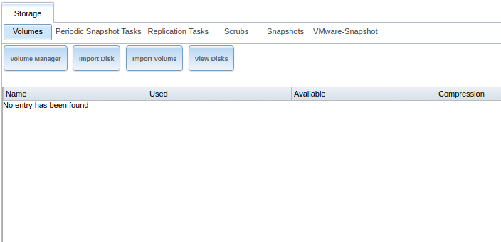

Hello All,
Here's my predicament; hopefully someone can point me in the right direction.
I moved recently and haven't had a chance to touch my server in some time. Just as I was getting ready to move I had a drive hard fail so I turned the server off and packed it up not thinking to offline the drive, export it or anything else (foolish, I know). Now that I've got the server out again, a new USB load of the latest FreeNAS and the drives (minus the hard failed one) installed I can't seem to import the degraded pool through the GUI; it just doesn't see it at all. When I tried importing through the CLI it gave me the usual warning about being in use by another instance so I used the -f option to force the import as I no longer had the config from the old server. This seemed to work well enough as I can now see the pool with the zpool status command but still nothing in the GUI. I tried using the offline command to drop the faulty disk then use the replace command but it gives me some errors about there being no such pool when trying to use the replace command. The replace command is confused a bit more by those ugly drive names in the zpool status output. I want to import the pool so I can add the replacement disk and resilver the array.

Okay, so I've got the new drive in the old slot. GUI still doesn't show the volume available for import and there are no replace options in the view disks.
Here is what the GUI shows me for disks:
I would not expect the GUI to show you a volume to import because the volume already is imported and mounted.
How about a screen shot of the View Volume Status screen? I am guessing that if you are looking at the View Disks screen that you didn't read the user guide on how to replace a hard drive, or you just made a simple typo. I prefer to give you the benefit of the doubt.

I'll see if I can get a screen shot when I get back home but there aren't any volumes listed in the volume status screen of the GUI which is why I was in the view disks portion rummaging for serial numbers of the disks.

Any screens shots you can provide would be helpful but your pool appears to be imported.
15,504
Agreed, the pool is imported. However, he imported it via the CLI, so it won't show in the GUI. @KMR, you need to export the volume ( zpool export volume), and then you should be able to import it through the GUI.

There is a bug - "Can't import a degraded volume" - https://bugs.freenas.org/issues/24368 that's targeted to be fixed in 11.0-U3.
I wonder if the OP imported the volume from the CLI.
If so, my guess, is that he'd need to do the replace from the CLI, export the volume, and then import it via the webGUI.

I've included a screenshot of the volumes tab under storage. As you can see there are no entries. Interesting about that bug; it does seem like it would apply to me. However, given the ugly names of the drives from the zpool status command I haven't been able to successfully replace the drive. Based on the output from my system above does anyone know the proper use of the replace command or a way to clean up those drive names so that I can use it?
