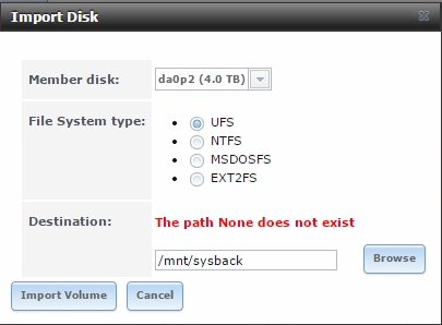

In attempting to Import Disk, an external USB hard disk, it displays the failure as shown on the attached file.
I don't know if this problem is related to this bug. If it is, I don't know how to perform the fix. Any suggestions?
I am using the external disk for backup and therefore cannot do it. Yes, I know this practice is not recommended and I am backing up to the cloud. Still, it provides some degree of comfort.
Thanks Larry

mjws00
Jul 25, 2014
798
The import function has changed. Looks like it tries to copy data to a pool instead of set a mount point. It's also broken with ntfs as far as I can tell. If you want to mount an external drive as per 9.2 I think it is CLI only. I only tested briefly but that's what I experienced.

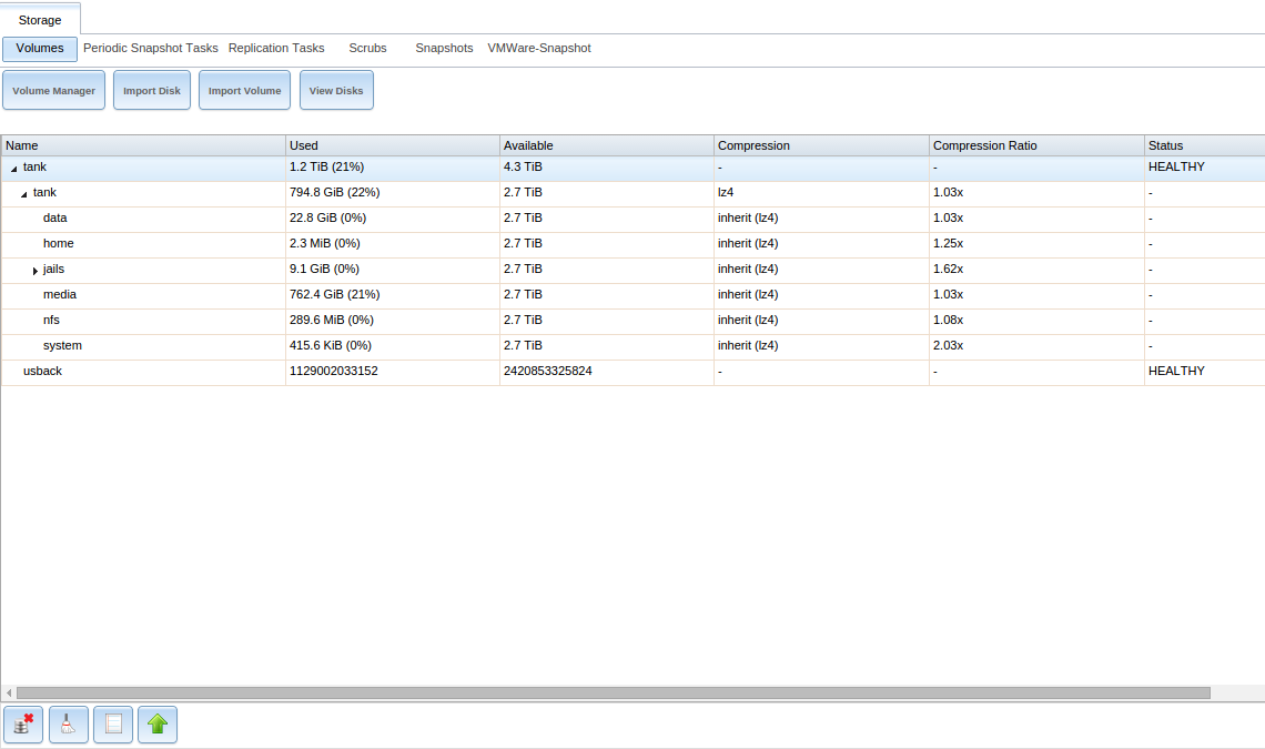

Thanks for the documentation, dlavigne. It explains what I was doing wrong.
I do not want to copy the data from the USB drive to a dataset. I want to mount the drive for writing/backing-up data from existing datasets.
What is strange to me is that on the machine I use at my office and running FreeNAS-9.3-STABLE-201412200530, I have done this successfully and am able to run rsync scripts to copy data from zfs datasets to the USB device.
/dev/ufs/usback on /mnt/usback (ufs, local, soft-updates, nfsv4acls)

OK, I understand. I have two questions.
First, how do you explain that I could/did import an existing UFS-formatted external USB drive and am able to write to it for backup purposes on my personal 9.3 system (see attached image)?
What do you recommend for backup now? Can I format a single drive zfs and use that for backup?

mjws00
Jul 25, 2014
798
Can't say I've looked too closely, but if the office 9.3 was an upgrade, it likely kept the fstab entry and the mount point.
The /dev/ufs/sysback won't exist on the second machine. The old UFS Volume Manager created that. Use the actual /dev/<device>. 'camcontrol devlist' will show it to you. The GUI is gone, but BSD is still BSD.
