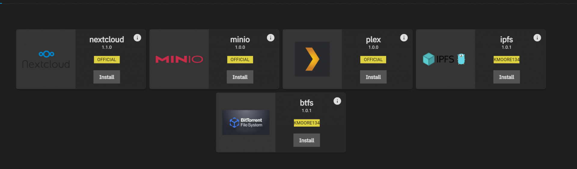

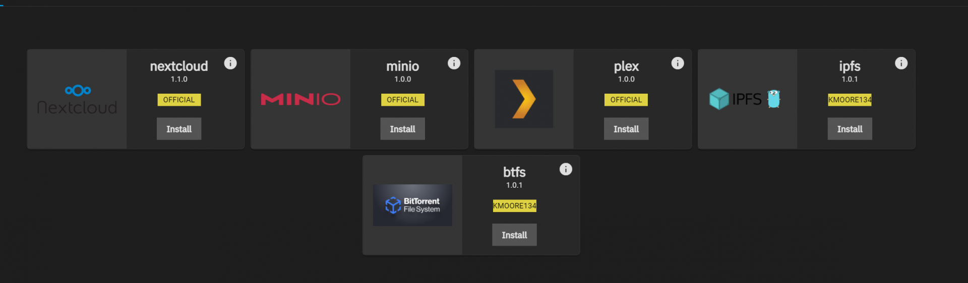

Kris Moore
SVP of Engineering
Administrator
Nov 12, 2015
1,471
For kicks I went ahead and put together a quick BTFS app for TrueNAS SCALE. The next scale update 21.02 launches in a few weeks, I can provide some further instruction on how to use it after that time if anybody wants to give it a whirl :)
