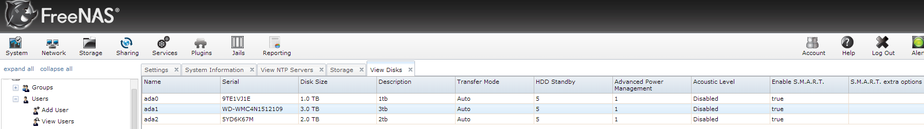

and the in the GUI ada1 is the 3tb hdd, or have i missed something? (screenshot attached)
