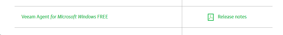

Sure.
1. Go to https://www.veeam.com/downloads.html?ad=top-sub-menu and download
2. Create an SMB share(s) on your FreeNAS box to receive the data from the Win machine(s).
3. Install Veeam Agent on each Win machine and configure the type and location of the backups you want, plus the desired schedule.
4. Test, fix as necessary.
