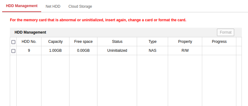

I have some security cameras that can use NAS. When I configure the NAS storage, the camera wants to 'format' the storage.

The cameras are Hikvision and can have local sd storage but can also use a network NAS. I need the use the NAS.
I set up a separate pool for the cameras with a limit of 1024mb. The camera can see it as shown in the image but it wants to initialize the storage.
I'm nervous that since the dataset is part of a single pool, that it could format a part of or section of the pool rendering the rest useless.
I'm nervous about that because all of the datasets have no limits, they all share the entire pool.

To me, it seems the camera thinks this is storage it can use, it can see it and it wants to initialize it, prepare it in some way.

I'm seeing tutorials about using network storage as well, e.g.:
But their terminology is just weird. They say "Net HDD" for SMB (or apparently other protocols) shared network storage. And then once you've set up that share you have to "format" it. I know, more or less, what formatting does for an actual hard drive; I can only guess at what it does on a network share in this context (and that guess is that they're creating a series of folders and perhaps index files). I haven't as yet been able to find anything that describes in any detail what happens on a network share when they "format" it.
But, for the third time: if you only give the camera credentials for one share, whatever it does will (and can) only affect that one share. It can't destroy your pool. It can't format your hard drives. It can't damage or affect data in other shares. That's the whole point of having different shares with different permissions.
