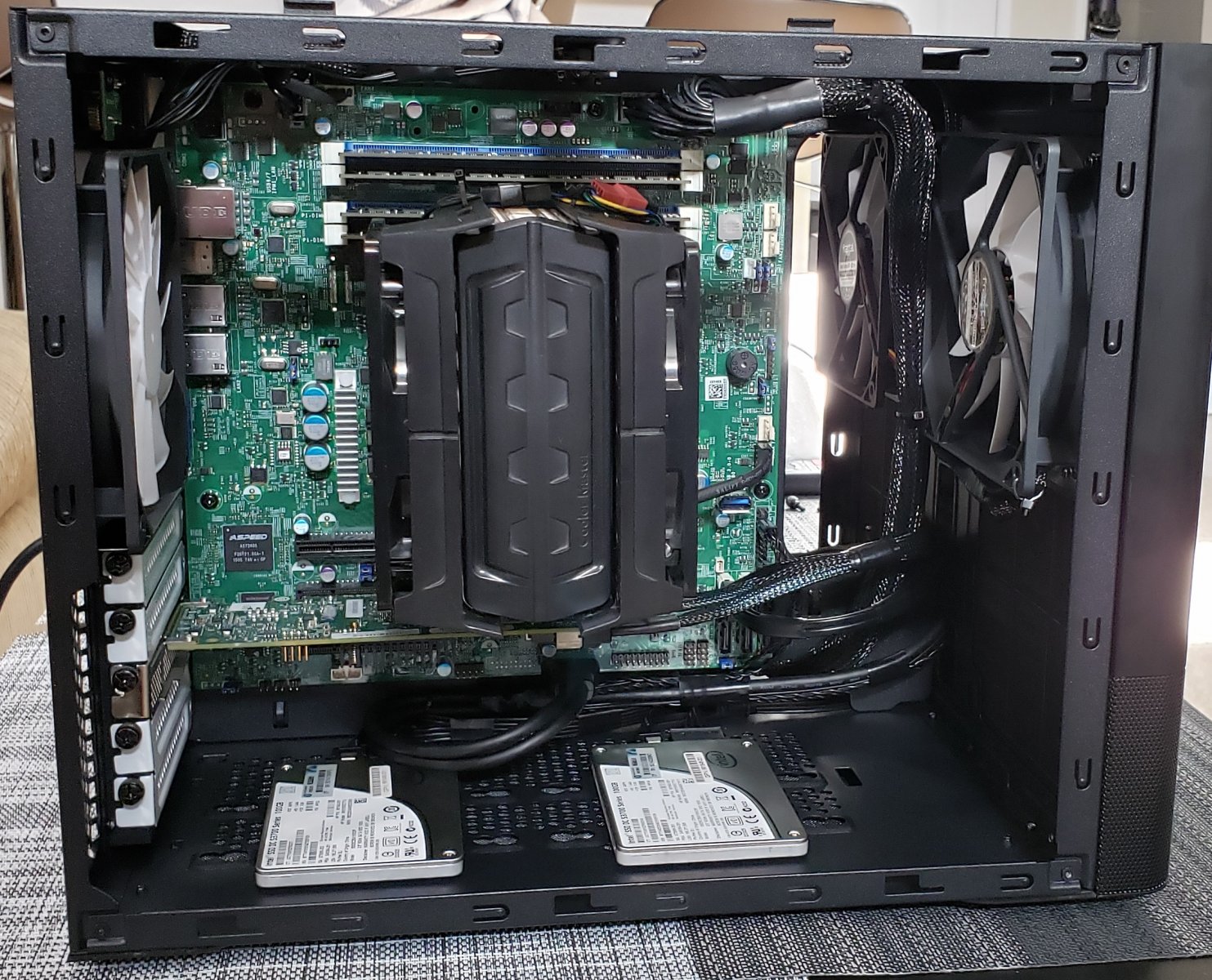

Steps to assemble are similar to regular PC build, nothing special. Only one note: you need an attached monitor through VGA port (!) to setup IPMI, after that everything can be done remotely.

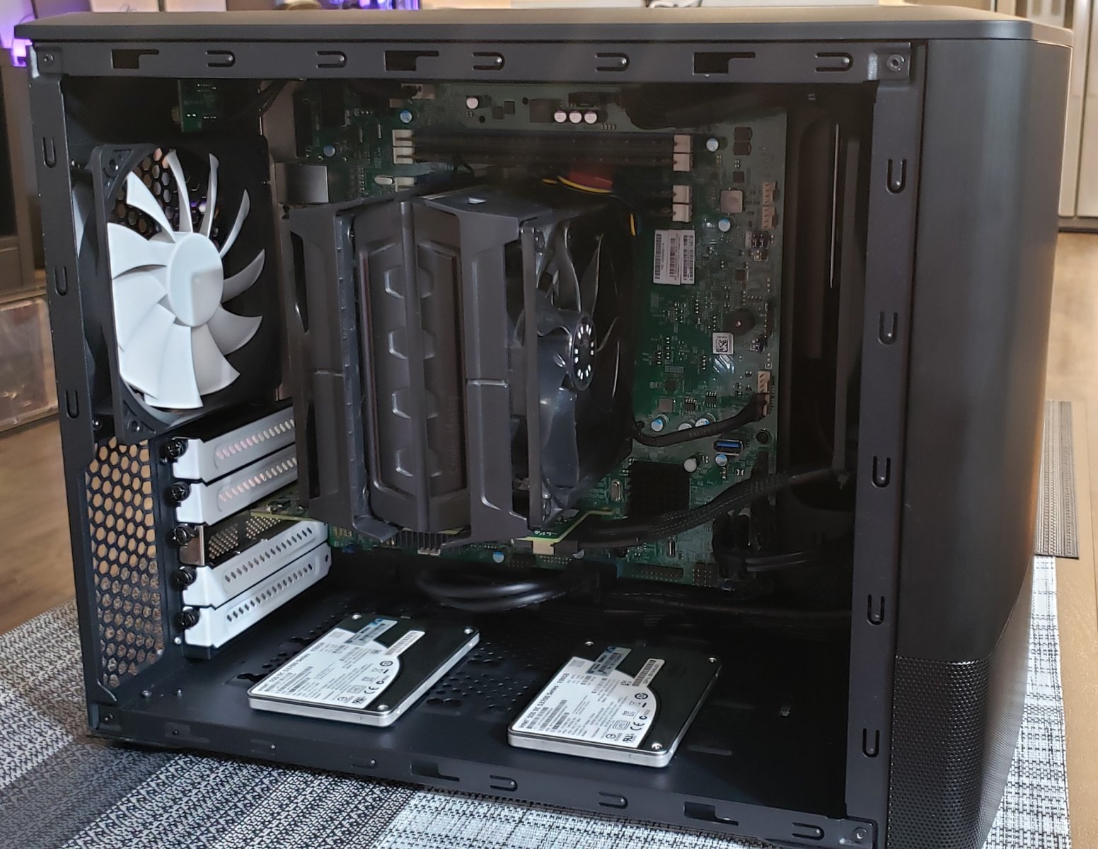

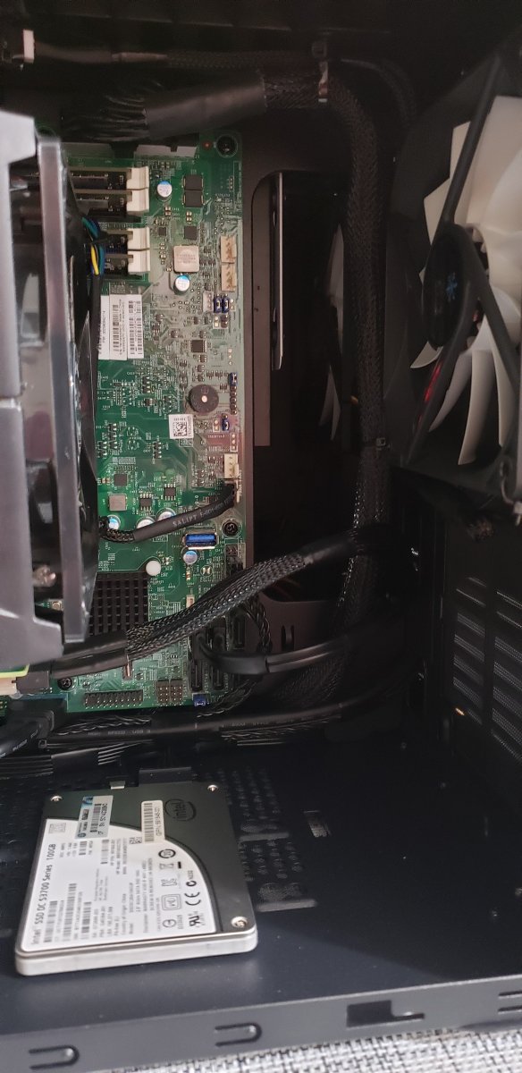

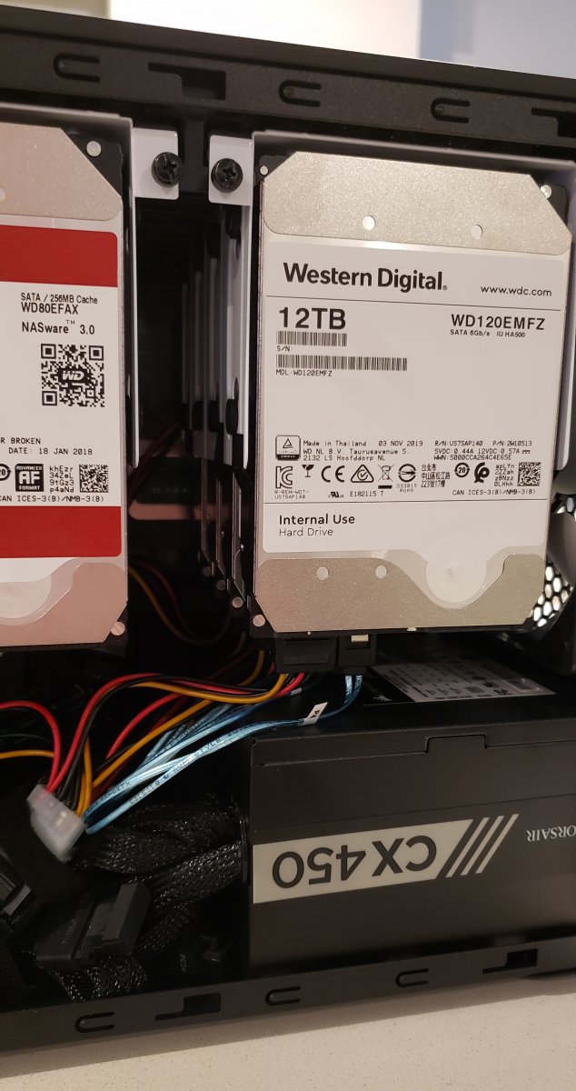

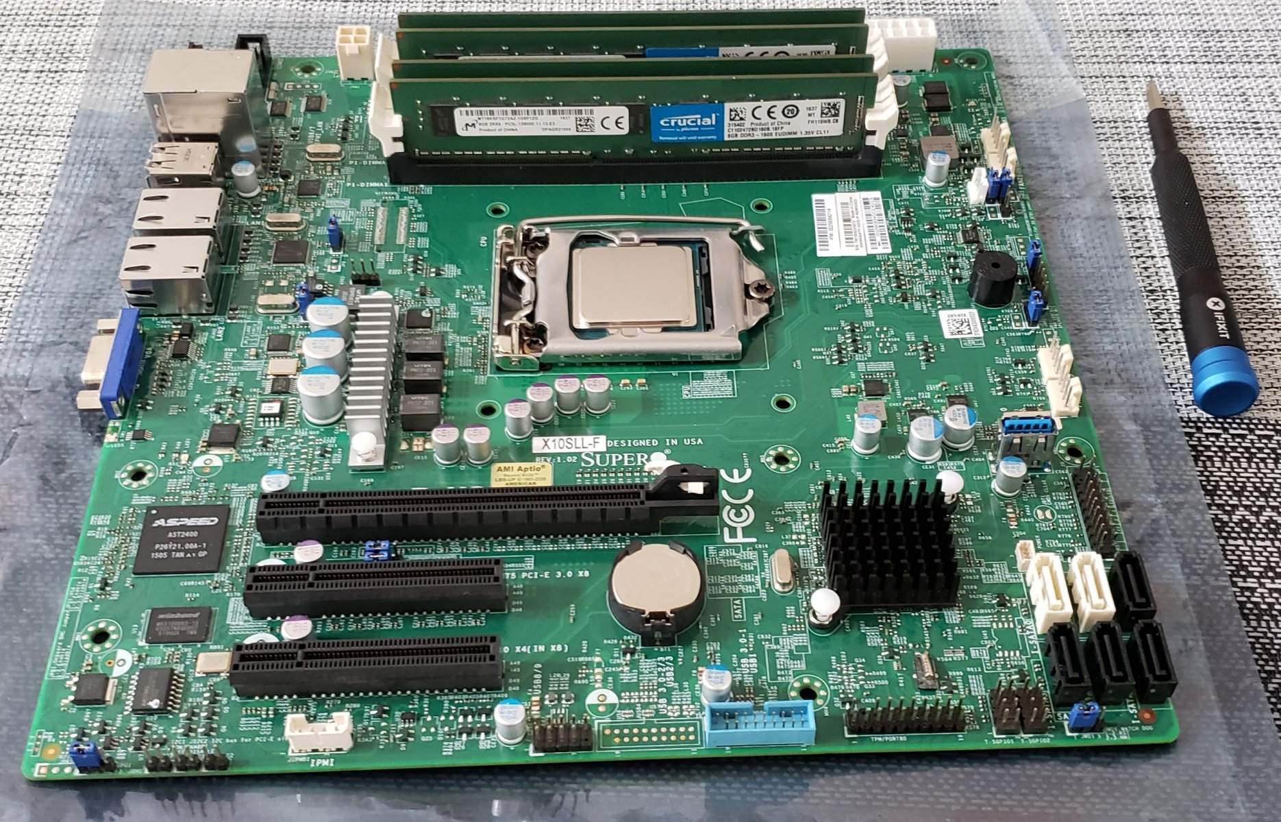

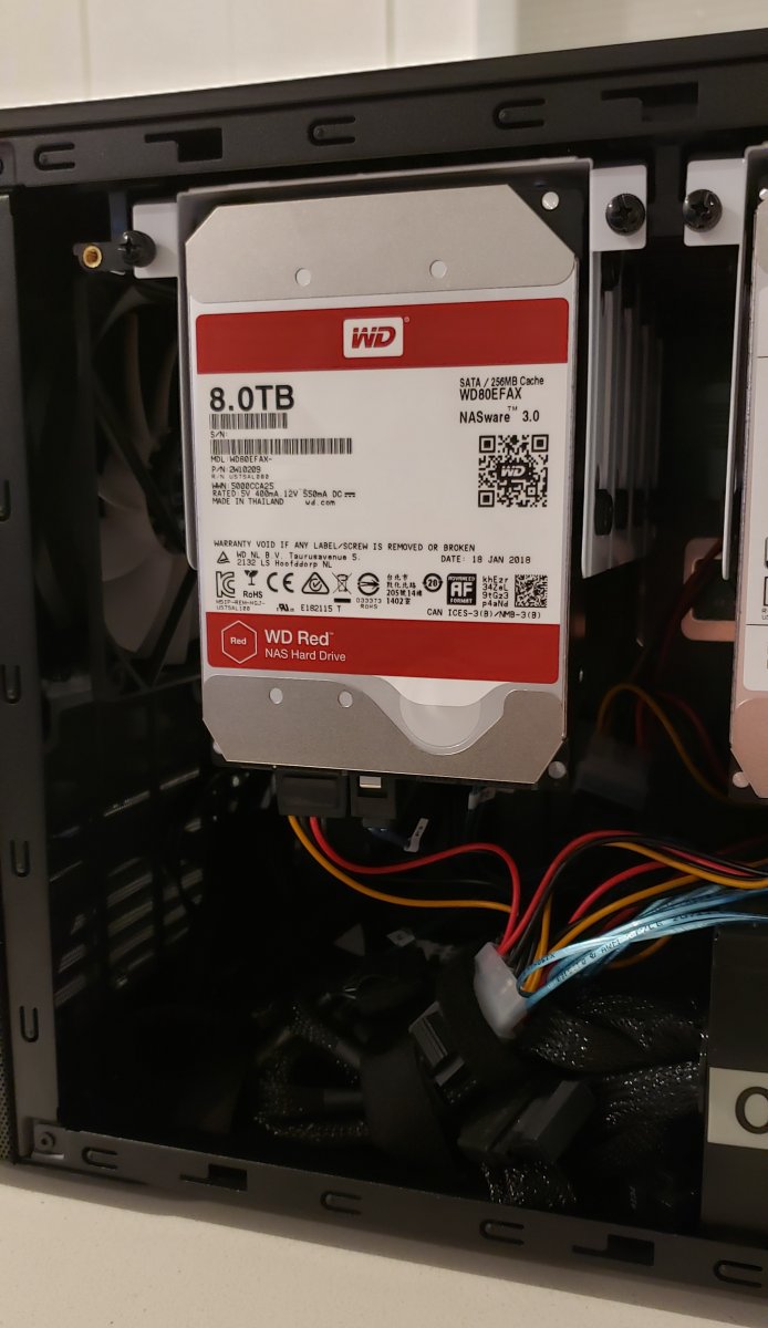

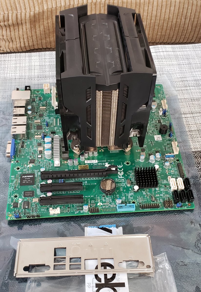

A few photos of assembling:
As a result, almost all my goals were achieved with this configuation (except syncronization and some backups, but it's more software issues than hardware).
