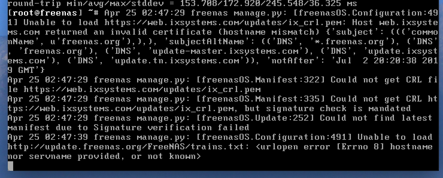

That didn't seem to help.. I confirmed with a ping test it was picking up the new IP of course, which it is... Simply put, 9.3 upgrade to anything is borked... Unless I hand ISO upgrade... We're looking at just automating the new deployment of 11.2 as fresh onto these hosts instead. We've got nothing to preserve data wise, so this seems like a good way forward also...

Oh right of course, once you put the hosts entry in the cert no longer matches, no dice.
You can still grab the file from update-master and stick it onto your own system pretending to be web, complete with cert. At some point the effort seems hardly worth it though, agreed.
