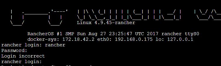

Hi currently i am trying to set up a docker VM in FN (latest) with rancher.
followed the steps:
https://doc.freenas.org/11/vms.html#docker-rancher-vm

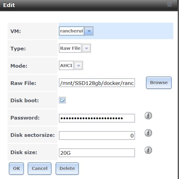

under devices, raw entered my own choosen password. Booted up the VM entered rancher as login and my chosen password. ->login incorrect.
Is this a bug or did i miss understand something?

could it be the case, that special character or the length of my password is causing this? with rancher as password it is working
D
dlavigne
Guest
Sounds like it. If you think it is a bug, create a report at bugs.freenas.org and post the issue number here. In the report, indicate which special character and how long a password you used that failed.
