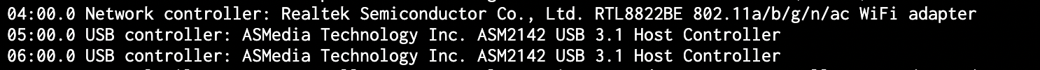

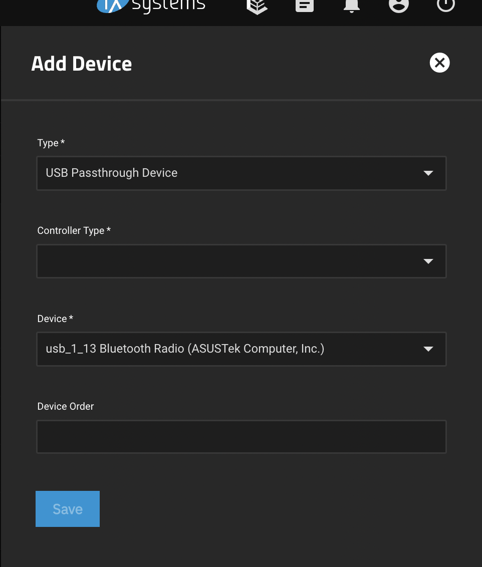

I've read that the onboard wifi and bluetooth are usually listed together, and the onboard wifi shows up as a pci device, but bluetooth shows as a usb device in the VM add devices tab.

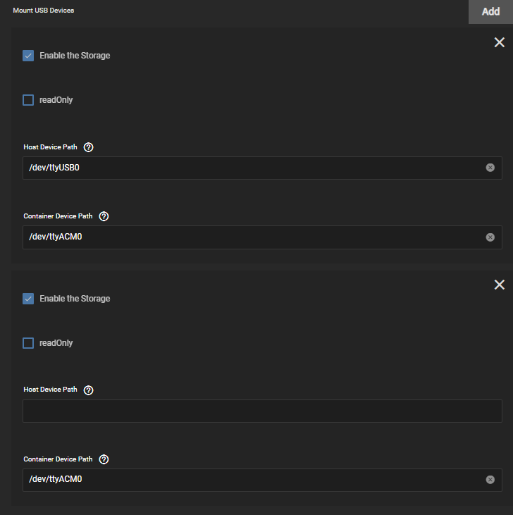

I'm not sure I understand. I assume it could be added under the usb tab, but I don't know how to find the device path.
9,700
Looks like you're in the right place... what's not making sense?
Can you not find which device path you want to share into the container? (looks like maybe it's /dev/ttyUSB0)
Do you not know what to share it as into the container? (can be the same as the host path if you see no reason to change it).
