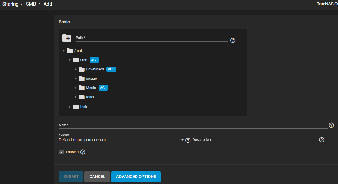

RAID-Z with 6 x 2 TB WD 2.5" drives: I did the upgrade, but then I could no longer access my share through the network. I switched back to FreeNAS and it worked again. I went to TrueNAS again and started messing with permissions and such. I am not sure what I changed that created my current problem, but the dataset disappeared, although the pool is still there after import. I can go to Windows SMB share and see the stuff in my dataset and share it. I can go to my PC and see the shared folders. When I try to open them, nothing happens at all.

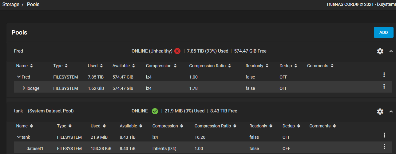

Now I know why I could not get it to work in the first place. I had it set for the root user, and TrueNAS does not allow shares under the root user. I added "reuel" as a new user, so if I could get the dataset to show up under Pool, I am sure I can get it to work. Is it possible for me to recover my dataset? It still shows a huge chunk of the drive array as having data.
Here, you see Fred with iocage, which was added for a plugin. The missing dataset is clearly quite big, as you can see that 7.85 TiB is used, while only 1.62 TiB is in iocage. Note that I have a second pool, which has enough empty space to hold the lost data if there is any possible way to move it in TrueNAS. It is on a second array of 6 x 2 TB hard drives. The plan is to clean the first array after copying everything to the second array...
I can share the folders in my dataset, except I cannot actually see what is in them.
