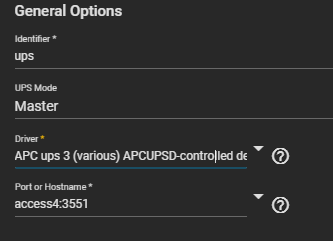

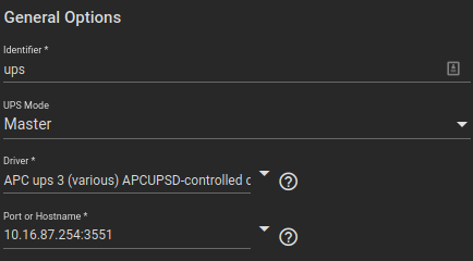

Adrian
Jun 29, 2011
166
I have this in the UPS service configuration:
