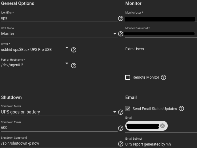

I recently bought a UPS and I have configured it using the web interface per the documentation instructions.
Using driver usbhid-ups$Back-UPS Pro USB, I can successfully run upsc ups@localhost and get status information from the UPS (see verbatim output in the spoiler below).

In order to verify the functionality of the UPS, I double checked that I did not have any critical operations running on the server; then I pulled the plug on the UPS. The UPS started beeping (as expected) and went into battery mode. The server remained on and I was still able to reach it.
I then checked my email - nothing.
I checked ups.log - nothing.
I checked messages - nothing.
I went to plug the cord back into the UPS, at which time the server did turn off. It is not clear to me whether the server shutdown when I plugged the UPS back in or if the shutdown occurred about the same time. According to my configuration, the /sbin/shutdown -p now command should be issued -- by the UPS service -- if the server has been running of UPS Battery for 10 minutes; but I was not close to this time limit. All in all, the server was running of the UPS battery for maybe a minute or two.
After a couple of seconds the server booted again (UPS now plugged in). I got an email from the System-email, notifying me about an unscheduled system reboot, but no info from the UPS Service.
QUESTIONS
  1. Does anyone have any idea why the email status updates does not seem to work? I'm not sure how they are intended to work, but I would expect at least one email when the UPS kicks in and start providing the server with battery power; and then another email once the UPS can feed "wall power" to the server again.
  2. Any ideas why the server decided to shut down during the test?
  3. If the UPS issued the shutdown command, should I still expect to get the unscheduled reboot email?

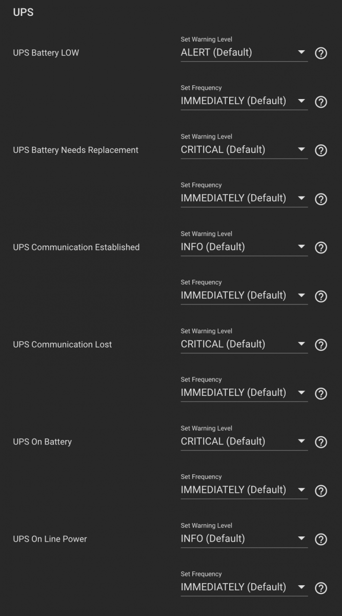

Not sure if you changed anything there, but under System | Alert Settings, you will find these in the bottom section:
If System | Alert Services isn't set up properly for email, maybe that's it?
