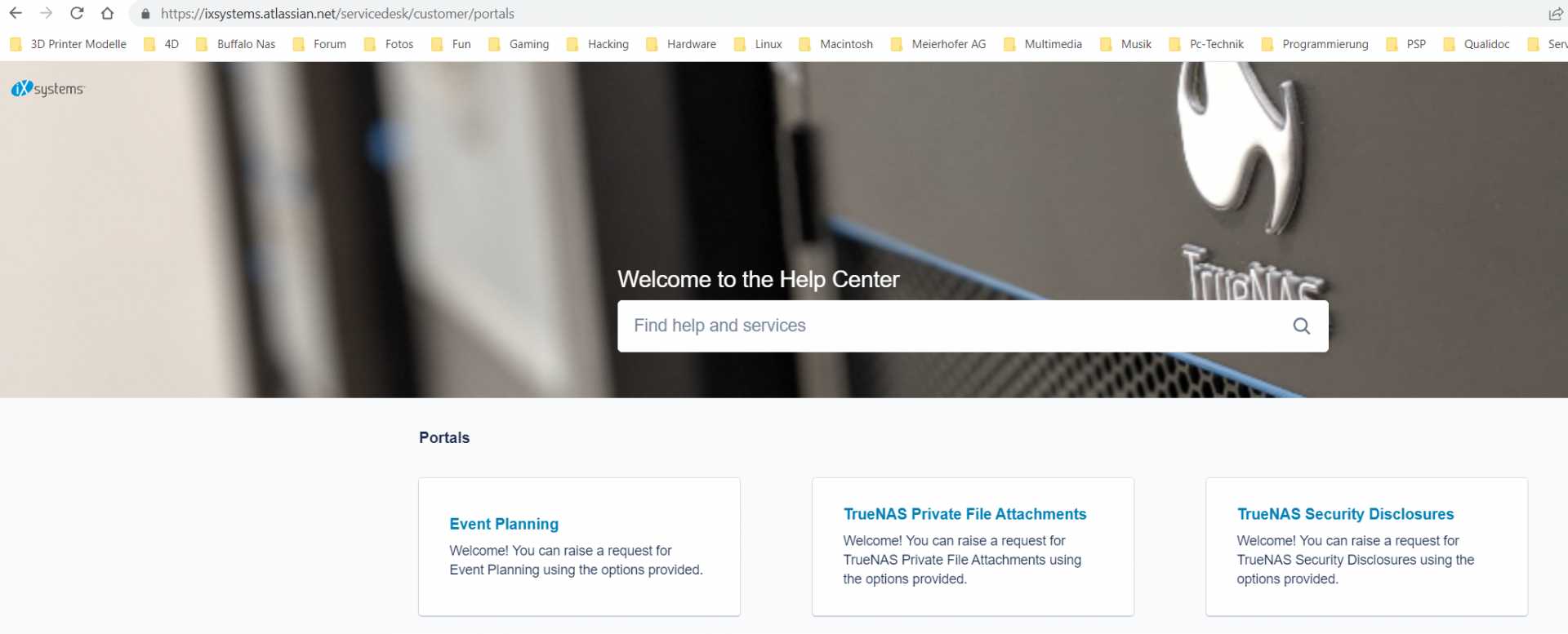

Sorry you're having trouble. Awesome that you debugged it. Could you PLEASE take a few moments to go to the top bar, look for "Report a Bug", and create a bug report? You may reference this forum thread in the bug report if that is more convenient for you.
Anytime someone solves a problem like this, it is best to ensure that this is put into the hands of the developers so that your debugging effort is not duplicated in the future.
Thanks.
TheNetStriker
Jan 27, 2022
11
