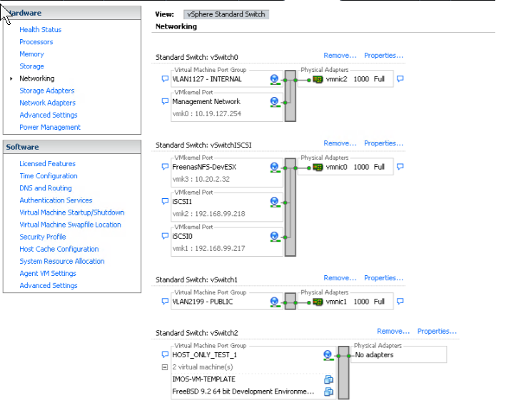

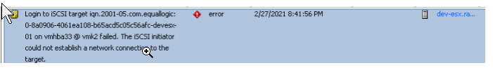

Major issues yesterday after a powerglitch: my vmware and my proxmox couldn't reconnect their storage to the freenas.
What can I do to fix that?

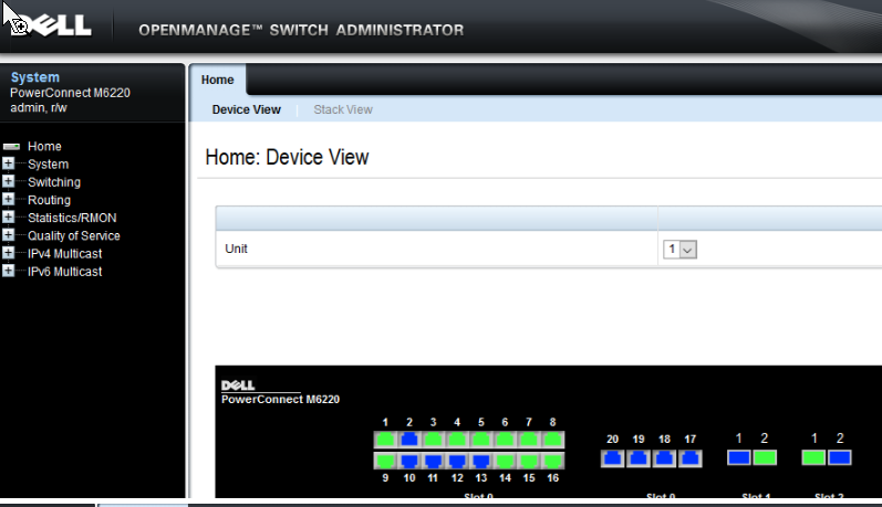

I tried rebooting individual blades of the Dell poweredge m1000e chassis, nada.

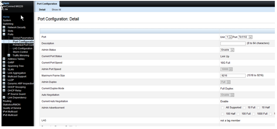

Tried rebooting the 10gb switch inside this chassi, nada.
Then I rebooted the whole chassis: nothing.

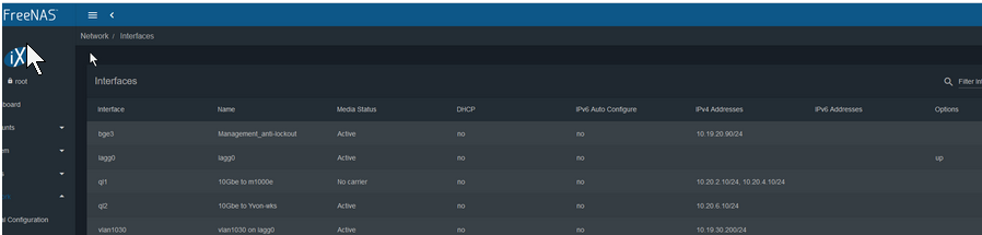

I just launch a reboot of the freenas after receiving this status
titan.x.com kernel log messages:
> ql1: link state changed to DOWN
> ql1: link state changed to UP
> em0: promiscuous mode enabled
> em0: promiscuous mode disabled
> ql1: qla_issue_cmd: cmd[0x001b2218] = 0x80000008
> sig[0x001b2228] = 0xcafe0101
> arg1[0x001b221c] = 0x00000001
> arg2[0x001b2220] = 0x00000000
> arg3[0x001b2224] = 0x00000000
> ql1: qla_issue_cmd: exit (ret = 0xffffffff)
> rsp = 0x80000008
> arg1 = 0x00000001
> arg2 = 0x00000000
> arg3 = 0x00000000
> ql1: qla_del_rcv_cntxt: Q8_CMD_DESTROY_RX_CNTXT failed

I still haven't figured out how many cables between the blade server and the freenas was in use... 1-2-4-6!
Seemes like there is only 2 10gb UP connection on the m6220 so I would guess one or both of them are for the connection to the freenas but again, don't know and don't know the issue.
In the free nas printscreen we see freenas media status no carrier... but even before that it was active and was still not working

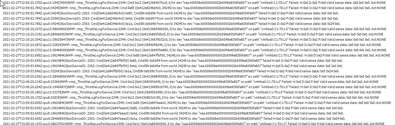

I do have some logs from vmware
But there is so many of them, I could attach it here but I see:
