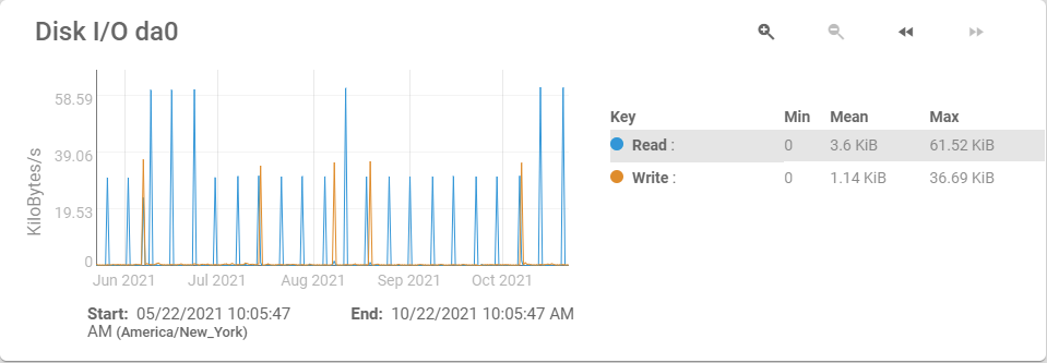

Any M.2 SSD and USB adapter will do. As for R/W rate, this is my boot disk:
There's almost no usage over the last 5 months. The read spikes are the weekly update checks. The write spikes are when I login to the GUI.
