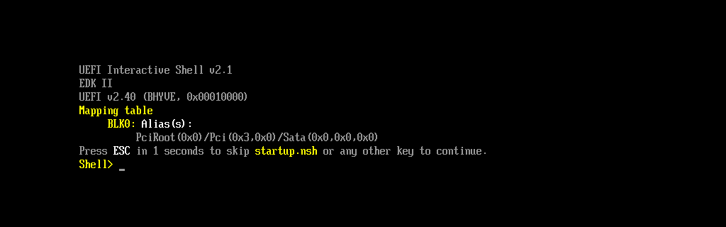

They won't start. They just drop into the UEFI shell, or the ISO installer if its still in the device list.
Mar 11, 2019
5

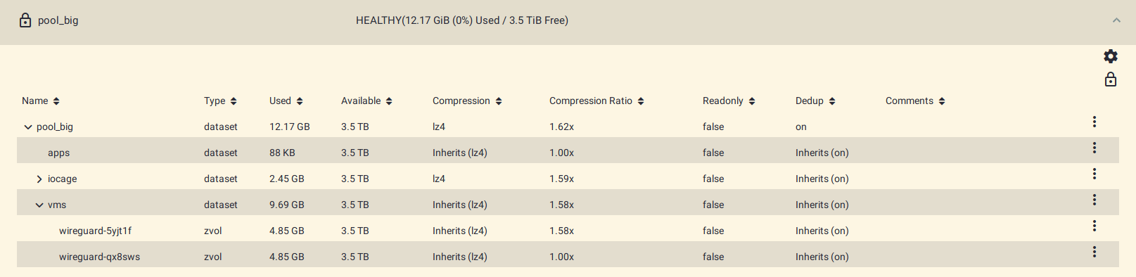

I encountered the same issue. I installed a Debian VM, and after the U2 -> U2.1 upgrade, it drops to the UEFI shell.
Inside the pool where the VM disks are stored, I see it got duplicated (wireguard-*), not sure if this is normal after an upgrade or this is how FreeNAS backs up.

I noticed this happens with Debian 9+UEFI when the VM is set to boot on start and you reboot FreeNAS. I tried with Ubuntu 18.04 and I had no such issue. Seems this has to do specifically with Debian, I haven't tried any other distro.
