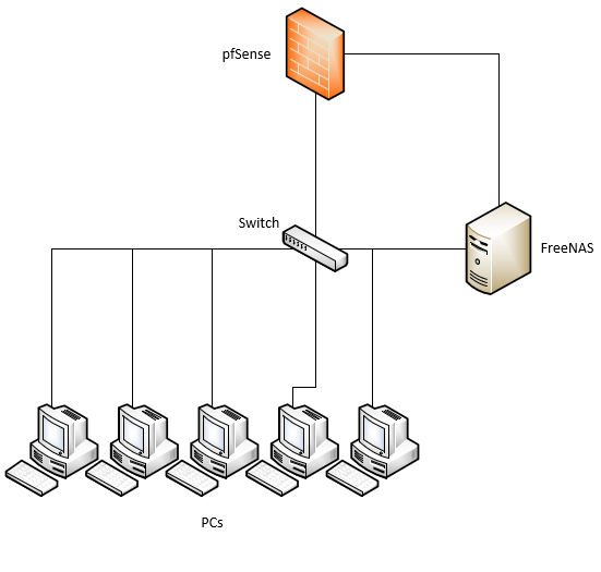

This particular net work is very simple. Think 10 machines hooked to a dumb 24 port netgear switch. Also connect to the switch is a pfsense firewall which connects to the internet. The freenas server is also connected to the netgear switch.
I think my question boil down to the following: Can I use the first NIC for freenas itself and the second NIC for VMs?
If this is not possible, the bridging seems to be the only route. In that case I did not understand the comment about "spanning tree loops". If you could explain that would be great.

An Ethernet network cannot have any physical loops, as broadcasts would then propagate forever, and no device would then be able to transmit. To prevent this, Ethernet uses the spanning tree algorithm to detect loops and disable links to break loops. In your case, using bridging would end up essentially doing the same as active/standby LAGG, as the FreeNAS server would introduce a deliberate loop into your network, and spanning tree would then end up disabling one NIC anyway.
If you want to use the second NIC for VMs, you could do something like this:
Create a 2nd subnet on your pfSense firewall, and connect the FreeNAS 2nd NIC to that. You'll need to configure your pfSense DNS/DHCP to manage the 2nd subnet's VM entries. On the FreeNAS server, the VMs would use the pfSense 2nd subnet IP as their default gateway. You'll also need to create rules on pfSense allowing the PCs to reach the VMs.
In this setup, I recommend you convert the FreeNAS server to static addressing, to prevent multiple default gateways configured on the server itself. The server should have its default gateway on the original subnet. The 2nd subnet should NOT have a default gateway. Only the VMs on that subnet should have a default gateway.
To force all your jails and VMs to the 2nd NIC, you'll need to create a bridge0 interface, and manually assign the 2nd NIC to it. Then any vnet or tap interfaces jails and VMs use will automatically bind to bridge0 and use the 2nd NIC.

As I was returning home from errands, it occurred to me that since pfSense is FreeBSD-based, you could create a pfSense LAGG interface to terminate the FreeNAS LAGG instead of the switch. Then on pfSense, you'd bridge its LAGG interface to the inside LAN, and you'd have a working LAGG on your FreeNAS server with both NICs active.

This is actually a great idea, which I had not thought of. It will require a NIC upgrade for my pfsense to accommodate the freenas server. I was planning for an upgrade anyway for other reasons.
