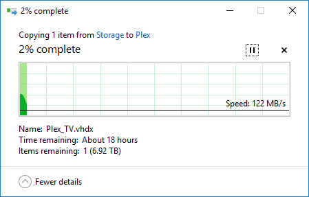

This is only a temporary configuration so I can move about 15 TB of data to the TrueNAS storage, but I'm concerned that it starts at about 800 - 900 MB/s and drops down to KB/s. I figure this is due to broadcast and setting up VLANs on the TrueNAS would be a great way to eliminate the problem.

Thanks for bringing up the obvious. After look at my system I realized I took out the controller and was using the onboard eSATA which dates back to Windows 98 I think, and old Marvell controller onboard.
Any replace the controller and I'm getting at least consistent throughput. I did follow you suggestion
As far as the bridge I didn't really see the need since the LAGs are direct connect and the Network is on a separate NIC
