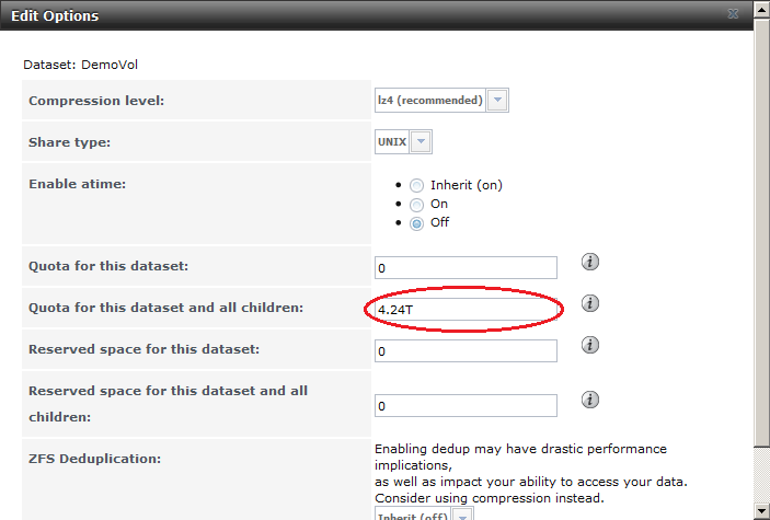

I usually set the Volume/Pool "Quota For This DataSet And All Children". Easy way is to take the "Available Space" and subtract 20%, then set it under the "Advanced" Options.
Example of a 5.4 TiB Volume (2 x 3TB Mirrors):
Some info per the Manual (Under "Table 8.1.4 ZFS Dataset Options"):
Quota for this dataset and all children
integer only available in “Advanced Mode”; a specified value applies to both this dataset and any child datasets
