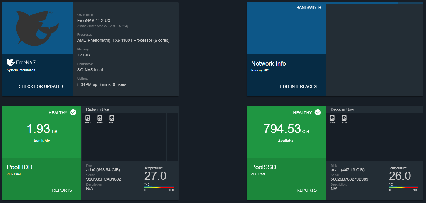

Hello,
I am running 11.2-U3 I am using a cat6 cable that is autonegotiated to 1000baseT. I have no idea what I did with my config to stop the bandwidth from loading on the dashboard page. I saved my config config and then did a reset to default and the bandwidth displayed fine. I then uploaded my past config and Bandwith is stopped showing. The last thing I was messing with when it stopped is I added a Server 2016 and Ubuntu VMs and connected via VNC to both vms. I also did add two ipv4 aliases on the interface. I have since removed those aliases. Thoughts I what I did?
I am currently getting comfortable with FreeNAS on a spare system. Once I finally decide on and plan out my setup I will build out using recommended parts.

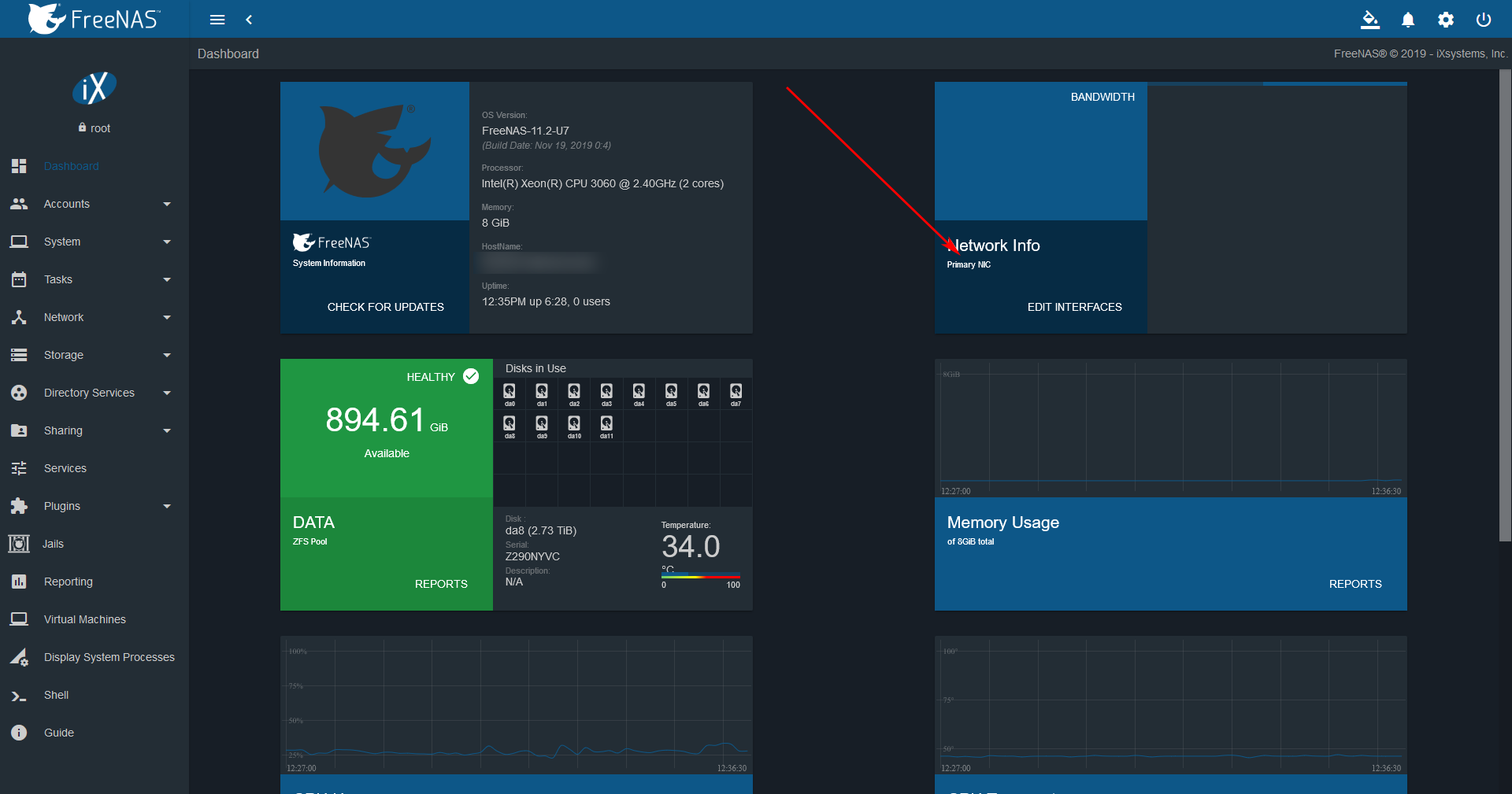

Following up on this post, we're experiencing the same issue.
As we've been doing a lot of experimenting we've been destroying/recreating pools and network links and I believe the problem is related to this.
Using this tip, we set the System Dataset to freenas-boot and some values (CPU, temp) returned, but not the network bandwidth which is still attaching itself to the Primary NIC. The working networking interface is actually the lagg0, not the original NIC. Reboots, moving the reporting to memory (System -> System Dataset), or location don't seem to fix it. Is there a way to force it, or is this a bug?
