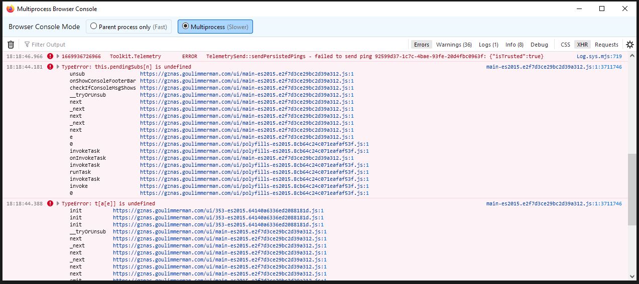

Next time you get the blank dashboard, could you share a screenshot of the browser's javascript console?
alink
Jul 8, 2020
9

Why is the dashboard so narrow? What happens when you make it wider?
The Dashboard should show something whether or not there are any drives attached. Try clearing the cache in the browser you are using.
If it happened when you removed the disks, you might want to check all your cables and connections. It's easy to bump something loose.
Good luck.

Damianos requested that i show a screenshot of the javascript console. That's why it's narrow, because the right side of the screen is displaying the console. Also, I've logged into the browser UI from different devices, so I doubt clearing the cache will do anything. I'll try inspecting cable connections as you suggest, but assuming it's not related to that, what would be another possible issue?
I'm starting to think i'll just have to wipe the boot drive and reinstall a fresh copy of FreeNAS.

I am suddenly getting this blank dashboard behavior as well. Attached is my browser console output. I don't know how to diagnose it. Can anyone point me in the right direction?

Very odd. I had a LAGG/LACP interface (part of a bond/bridge) that was not tx/rx-ing (bad cable). When I replaced it the Dashboard came back! Shoudl this be considered a bug iX should look at?
