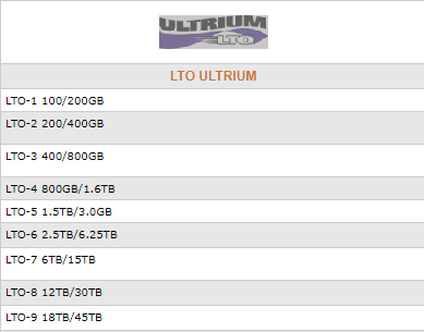

Hi, sorry to come late to the discussion , just wonder what did you end up using?, i been looking int o the the same thing , long term backups. i was looking into the same options except that i didn't see anyone mentioning the LTO Ultrium ( the Tape Drives)
some years later but here is a table of capacities, i was looking to get the lto-7 or up but a bit pricy.
the drives like in this store:
Most manufacturers estimate that LTO tapes will provide dependable data storage for 15-30 years. However, LTO archives require precise storage conditions. Slight deviations in temperature or humidity can affect storage life. Ideally, LTOs should be stored at 61 to 77°F (16 to 25°C).
i was looking in the M-discs but to low capacity.
