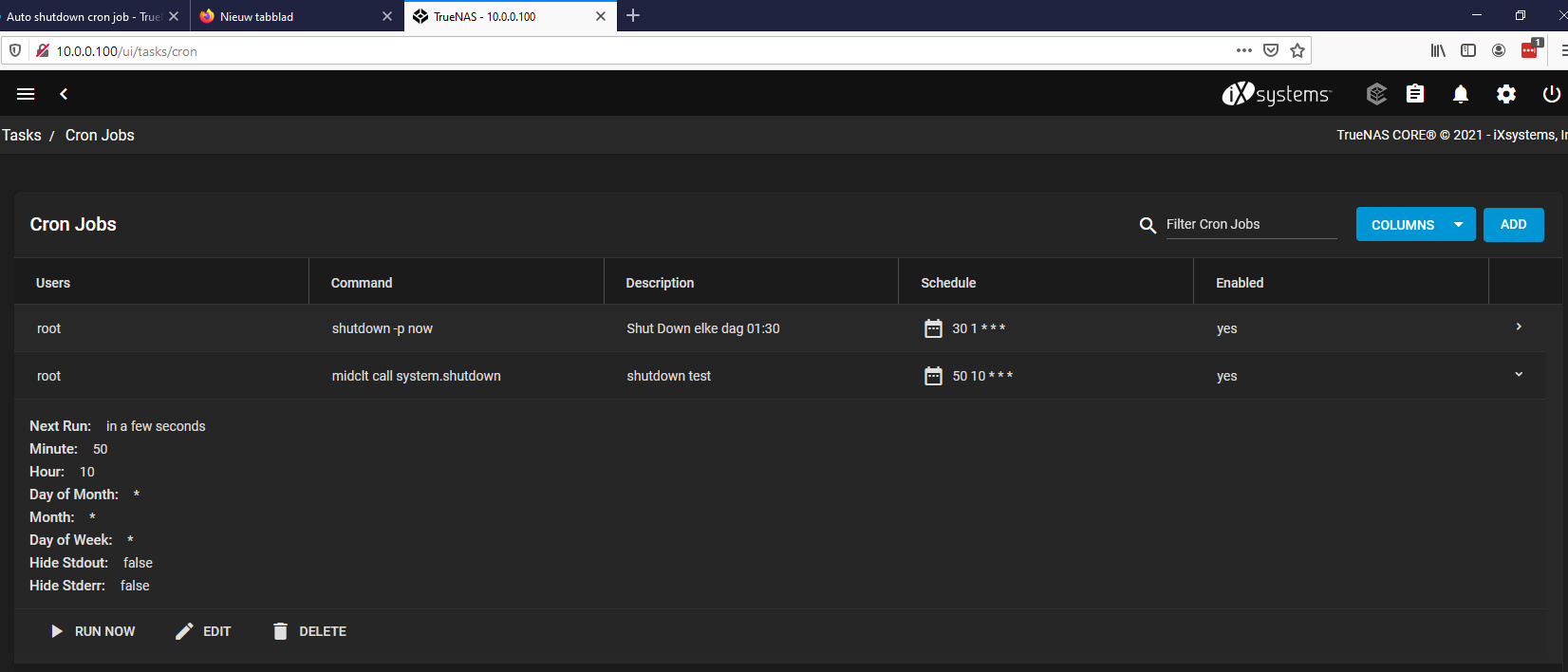

I have a Cronjob with the following parameters
Description: shutdown test
Command: shutdown -p now
Run as user: root
Schedule: Custom (16 * 14 * *)
Hide standard output disabled
Hide standard error not checked
Enabled checked
If I test this job with "run now", I always work.
But it does not work at the scheduled time.
When I look at ui/system/general I can see that the time zone and current time are correct.
If I set a time in the track that is 3 minutes away, it says Next run: in 3 minutes.
But nothing happens

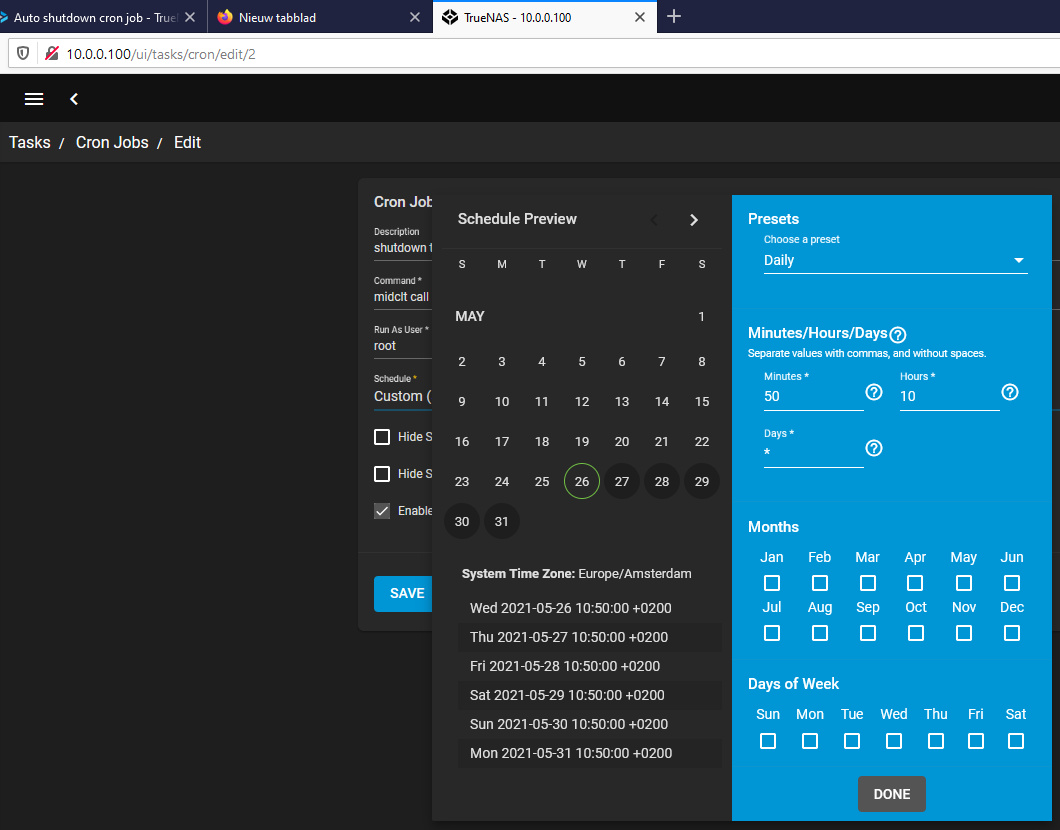

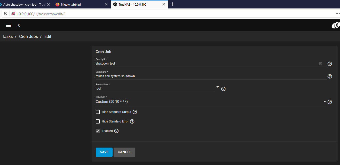

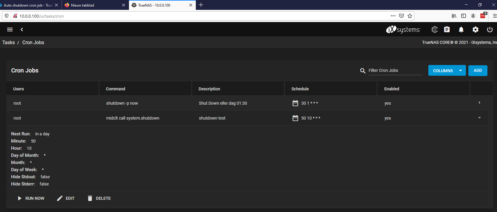

Can you show how you have configured the schedule?
Wim1969
Jan 10, 2021
10
