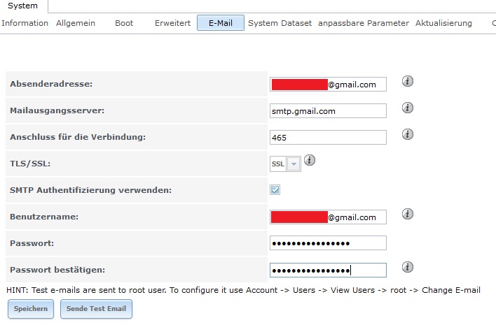

Sorry, I need some help.
I followed the instructions step-by-step EXCEPT the point "allow less secure applications" because I can`t find this option in my Gmail-Account. I read that I need an admin account? I just have a "normal" Gmail account. But I think "allow less secure applications" is not necessary when I make it with "2-step Verification"?
So I generated a new app-passwort in googlemail. Copied this passwort to the eMail settings in freeNAS
My eMail settings in freeNAS look like this (sorry all in german but I think its comprehensible :))
under the red boxes is my eMail for example maggo@gmail.com
Same eMail for user "root"
But always get the error [Errno 8] hostname nor servname provided, or not known when I try to send a testmail :(
Can anybody tell me whats wrong?

Can you paste a copy of the error? It sounds like you might not have your nameserver or gateway configured.
I use port 587 and TLS.
This is the error message when I try to send a testmail

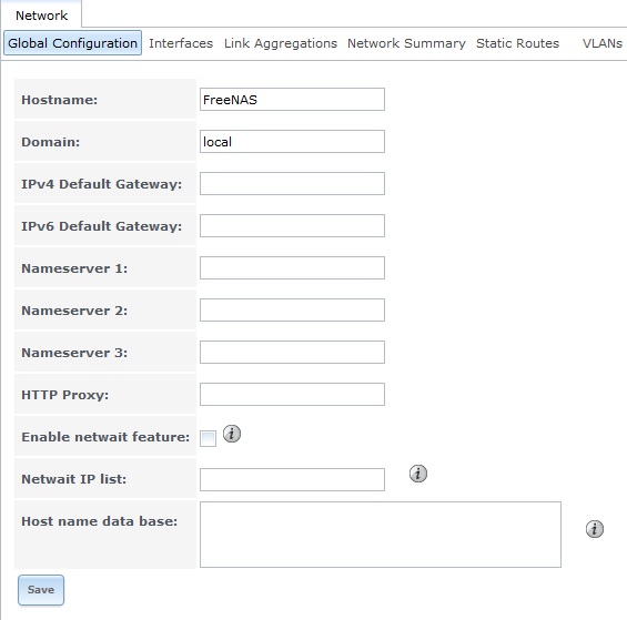

@Maggo, I'm guessing you don't have networking setup properly. Open a shell and ping smtp.gmail.com
You should see something like:
[root@freenas1 ~]# ping smtp.gmail.com
PING gmail-smtp-msa.l.google.com (209.85.201.109): 56 data bytes
64 bytes from 209.85.201.109: icmp_seq=0 ttl=42 time=29.393 ms
64 bytes from 209.85.201.109: icmp_seq=1 ttl=42 time=30.054 ms
64 bytes from 209.85.201.109: icmp_seq=2 ttl=42 time=31.507 ms
^C
--- gmail-smtp-msa.l.google.com ping statistics ---
3 packets transmitted, 3 packets received, 0.0% packet loss
round-trip min/avg/max/stddev = 29.393/30.318/31.507/0.883 ms
[root@freenas1 ~]#
Do you have a nameserver and gateway configured?
^C
[root@freenas1 ~]#
OK, this is what I get:
[root@FreeNAS ~]# ping smtp.gmail.com
ping: cannot resolve smtp.gmail.com: Host name lookup failure
Think this is not this what you want to see. So therefore I think my configuration of nameserver and gateway is completely wrong.
settings see here:
So you may have the patience to explain me what I have to set it up?
Thanks in forehand

There's the problem. You need to fill in your default gateway and nameserver info. The gateway is specific to your network. If you are using a basic home router, it it very likely 192.168.1.1 (but double check with your computer). And you can use googles DNS server - 8.8.8.8.
Thank you very very much depasseg for your help!
I think it works
PING gmail-smtp-msa.l.google.com (74.125.136.108): 56 data bytes
64 bytes from 74.125.136.108: icmp_seq=0 ttl=47 time=35.852 ms
64 bytes from 74.125.136.108: icmp_seq=1 ttl=47 time=42.620 ms
64 bytes from 74.125.136.108: icmp_seq=14 ttl=47 time=33.417 ms
64 bytes from 74.125.136.108: icmp_seq=15 ttl=47 time=35.399 ms
^C
16 packets transmitted, 16 packets received, 0.0% packet loss
round-trip min/avg/max/stddev = 33.417/36.390/42.620/2.136 ms
[root@FreeNAS ~]#
Also get a Testmail
