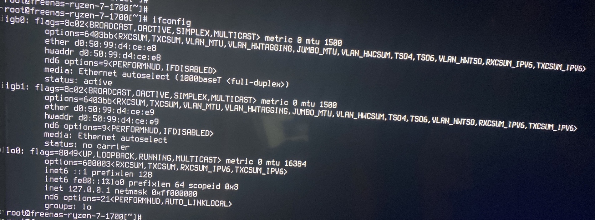

I'm hoping one of you guys can help. I don't know if I'm being dumb, ignorant [or both], but I can't get [ethernet] networking functioning and it's driving me crazy:
New X470D4U m/board with Ryzen 7 2700 and 32 GiB ECC PC
[As a pre-test, I set up the motherboard/CPU in a test case/PSU; Windows 10 Pro installed successfully to a 256 GiB NVMe SSD, and networking worked with no problems].
I already had/have a fully functioning FreeNAS [USB] set-up on other motherboard/CPU.
IPMI functions correct - gets an IP address via DHCP [ethernet] and I can happily interact with it via another computer on my network via ethernet.
[I even used the web interface to flash the BIOS from 3.10 -> 3.30].
FreeNAS - I simply can't get it to work with the Ethernet ports/network interface; it never connects to my LAN and can't be pinged or find it's own
DHCP address.

Here's the output of ifconfig:

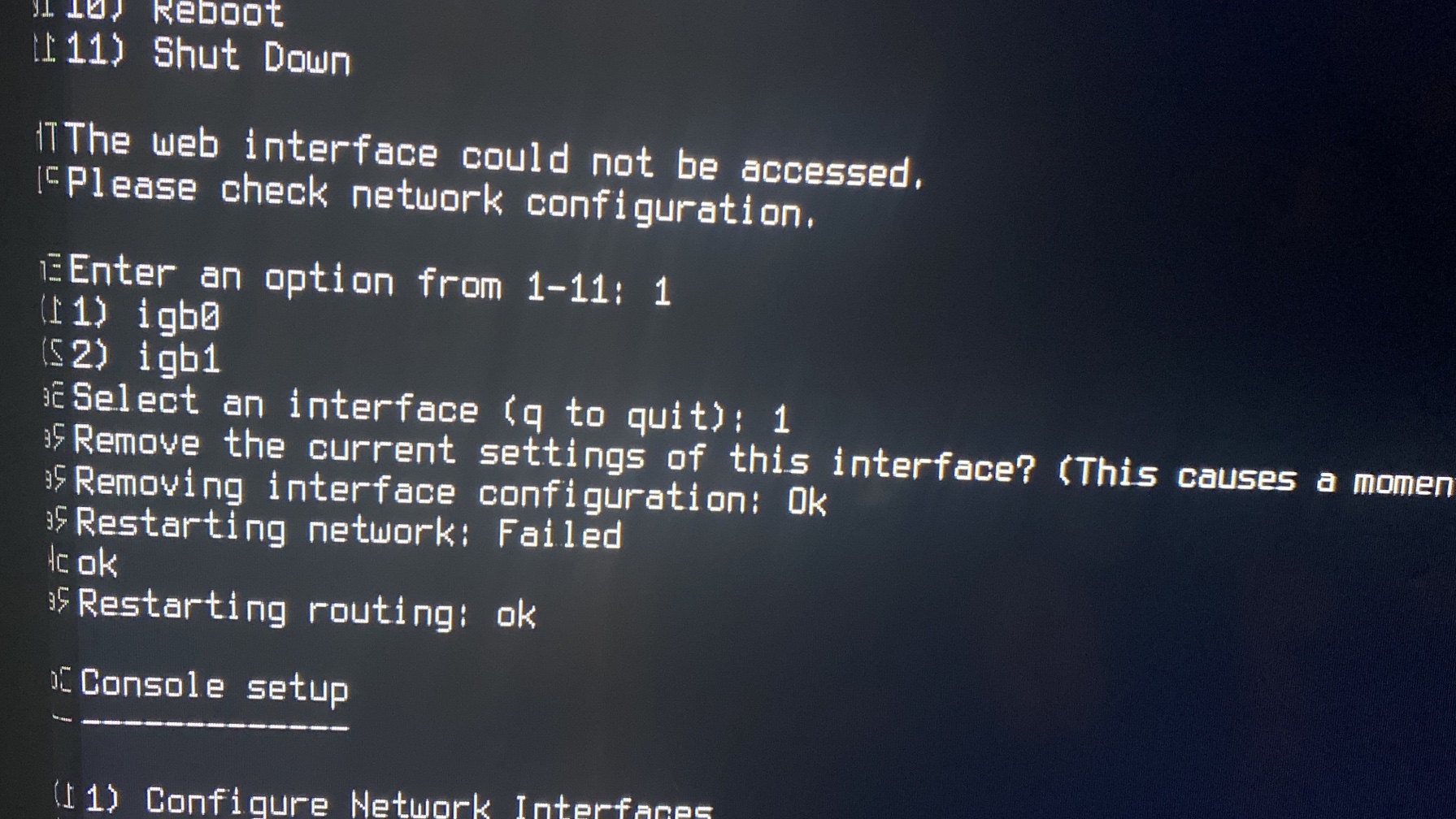

..and trying to reset the network interface [igb0]:

So - and sorry for multi posting in this thread - I was able to manually configure the network interface [assigning a static IP address, and turning of DHCP] and everything appears to now be working fine... :oops::oops:
I assume that the IPMI interface was interacting with the DHCP server and preventing ability for igb0 to get assigned an IP address, but I had tried turning off that in BIOS [or at least though I had]? Weird that DHCP worked in Windows and Ubuntu,but not FreeNAS...
Anyways, sorry again for the multiple posts.

To be honest I did not have any such issues once I configured my network interfaces from the command line. I also run FreeNAS on a static IP and the IPMI on DHCP which works ok for me. I do remember that I set up DHCP for both FreeNAS and IPMI in the beginning and that worked fine as well. In general the interfaces are all separate, with each having a dedicated MAC address. As such they can all work independently and there should be no competition between IPMI NIC and others if they are configured correctly.
The IPMI interface is configured to DHCP out of the box hence this was working straight away. In FreeNAS you need to configure the interfaces first. Since in your screenshot the interface failed to start I would suspect that there was an issue with the config that you resolved afterwards by resetting the configuration.
