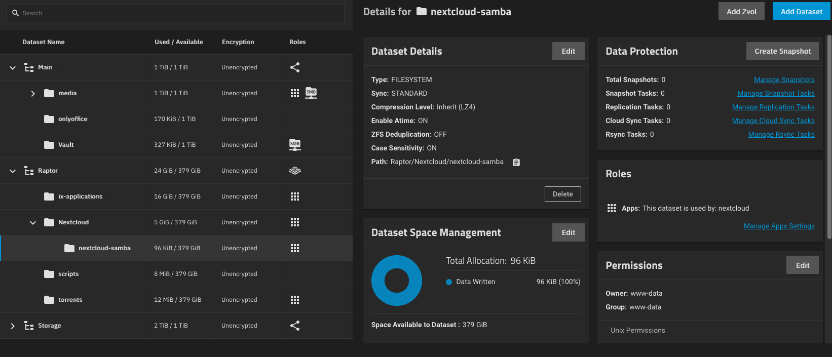

So I did that with my nextcloud not in explorer but copied the directory recursively in cli and now I turned on Hostpath Validation back to no avail.
Volkodav
Mar 27, 2022
26
I am getting this error when clicking on a child dataset: middlewared.service_exception.CallError: [EFAULT] Failed to get group quota for Raptor/Nextcloud/nextcloud-samba: [cannot get used/quota for Raptor/Nextcloud/nextcloud-samba: dataset is busy

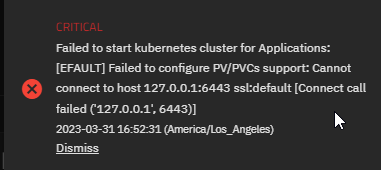

routeswitch
Jan 30, 2023
I'm having this exact issue, every time I try and update, kubernetes will not start and my apps will not load. This is the error I get. I'm on a Dell Poweredge R730 with a Intel(R) Xeon(R) CPU E5-2630 v4 @ 2.20GHz and 48gb ECC ddr4 ram
