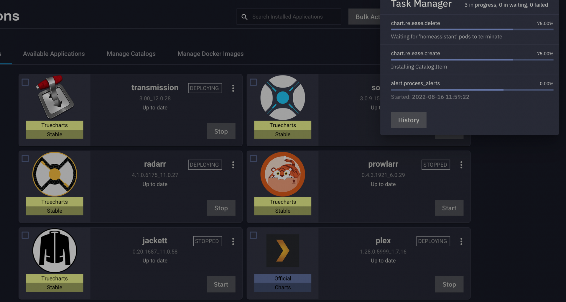

I've just migrated from Core to Scale 2 days ago. I thought this would just be a case of re-installing my plugins and copying over the config but every app I install is stuck in Deploying. I've waited on them for several hours.
I've tried to delete the apps and start again to get something working, some have got stuck in "Waiting for pods to terminate" I've rebooted several times and none of them are working.

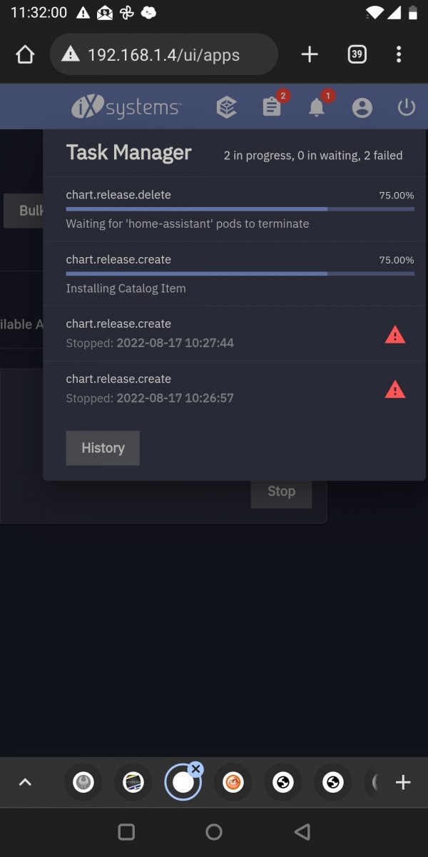

I've fully deleted the ix-applications folder after a reboot and setup the apps pool settings again. I've currently installed Home Assistant and Plex and I'm waiting to see if given time it will start.
With Home Assistant, It's not showing in the installed applications tab and the activity monitor is showing this (as it did before):
Installing catalog item 75%
Waiting for 'home-assistant' pods to terminate 75%
Is this normal for setup?
(the 2 failed items are where I tried to use upper case characters in the name)

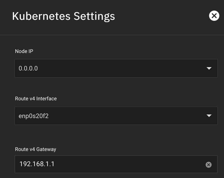

You must configure some Kubernetes networking settings else you'll get that 'Network is unreachable' error. Under Apps -> Settings -> Advanced Settings select the "Route v4 Interface" to be the network interface you use, and also the gateway. Just make these match your NAS's networking. The interface is the network card your ethernet cable is plugged into, and the gateway is just your router IP.
I don't understand why these don't get populated for you, but they don't. Feel free to submit a Jira ticket for it.

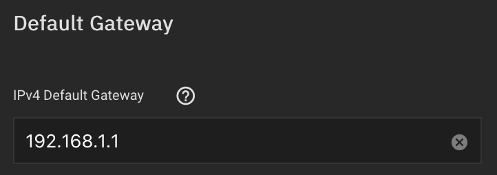

You must also specify a default gateway in Network -> Global Configuration -> Settings. Again you're just copying what DHCP returns, but for some reason you must duplicate it again manually.
Thank you, this fixed it for me. My apps were stuck deploying after a reboot (evem though they worked fine before) but deployed again after your fix.

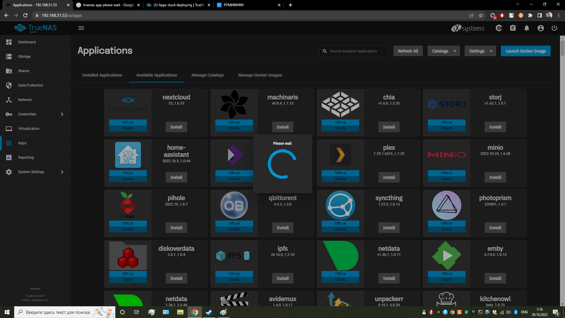

I am having a little different issue. When I click install on any app I just get "Please wait" pop up with no way to close it and it stays active permanently. I can only exit it by refreshing the page. No error or anything like that. Logs are clear too...

I just got everything working. This will not work for everyone, but worth the try:
At first I thought to re-install TrueNAS (it's just a some server for fun, so this is no big deal). But instead I upgraded to BETA release. Apps started to install, but fail on 75%. I than rollback to stable version and everything just started working!
