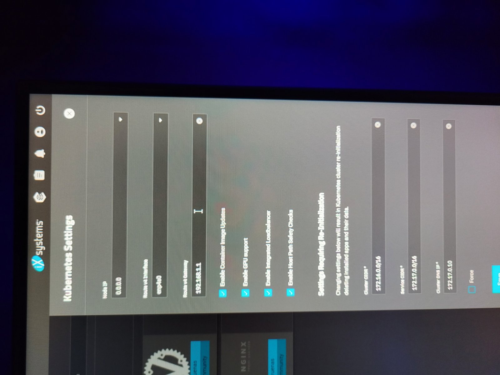

The issue is with Kubernetes being unable to start preventing my apps from getting a chance to start. When I boot, it says Applications are not running on the apps screen. When I check the notification, it says that Kubernetes was unable to bind the ipv4. I will try to get the notification to help.

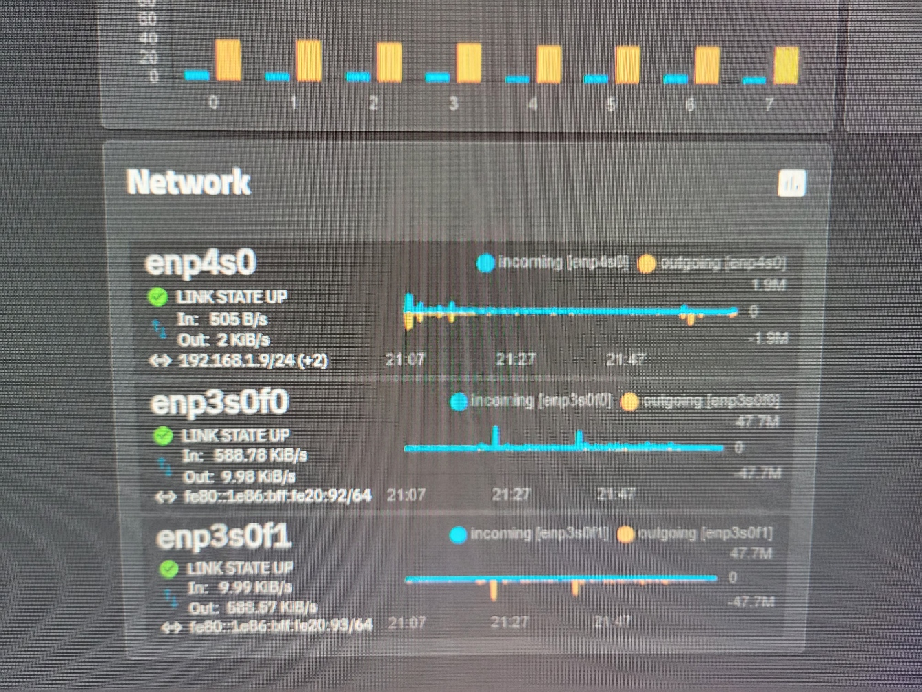

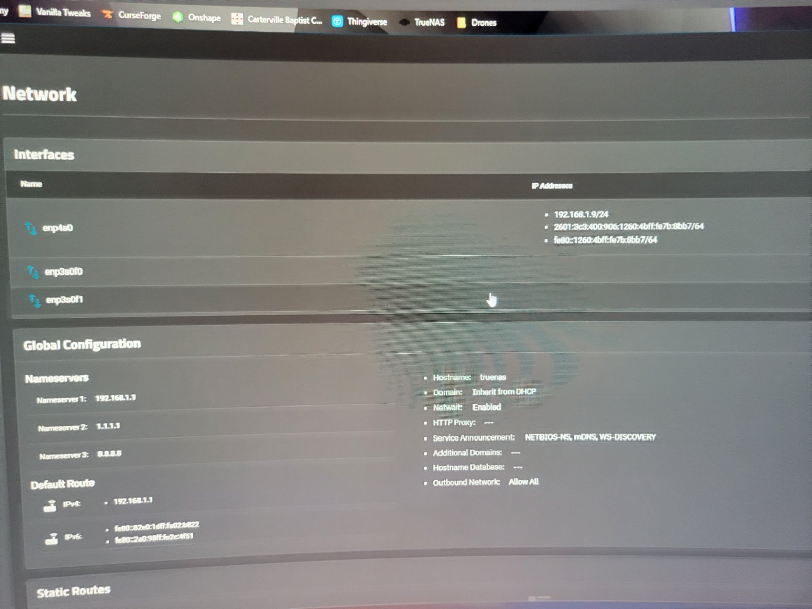

My Server is using DHCP with netwait enabled. I have one network port on the motherboard and I pass through two ports on a nic to the VM but truenas still sees both of the ports. The first picture is of my network settings, the second is of the apps network settings, and the third is of my network interfaces.

Setting the Ip to static seems to have fixed it. I didn't bother with bridging the ports for my vm because I didn't want to risk messing up my VM and breaking my network because it hosts my router. Thanks for all the help!
